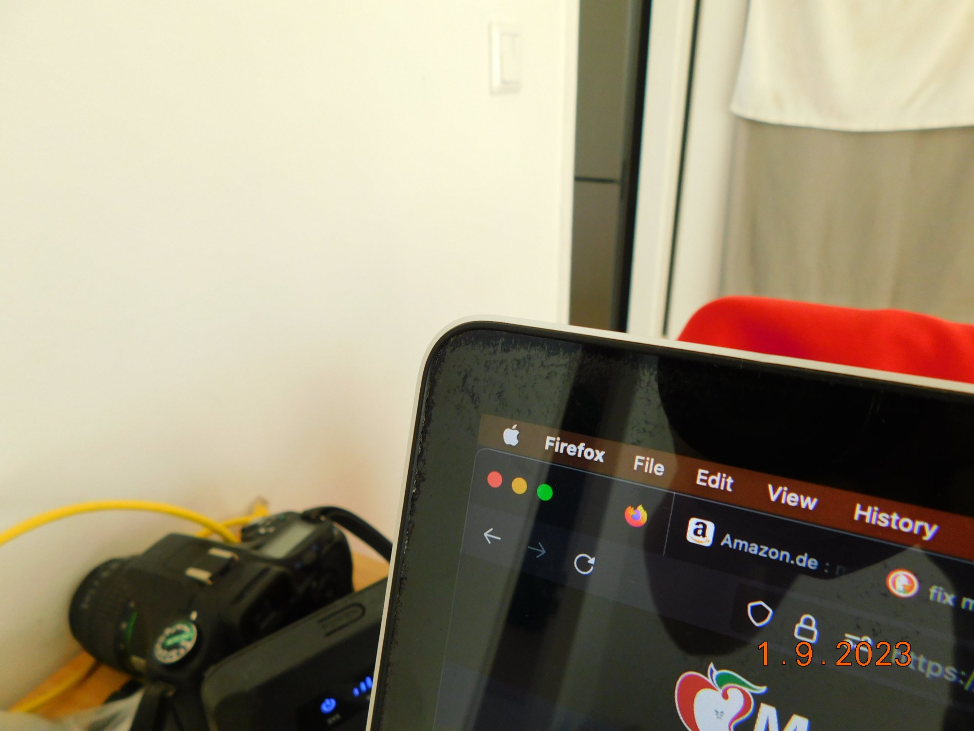

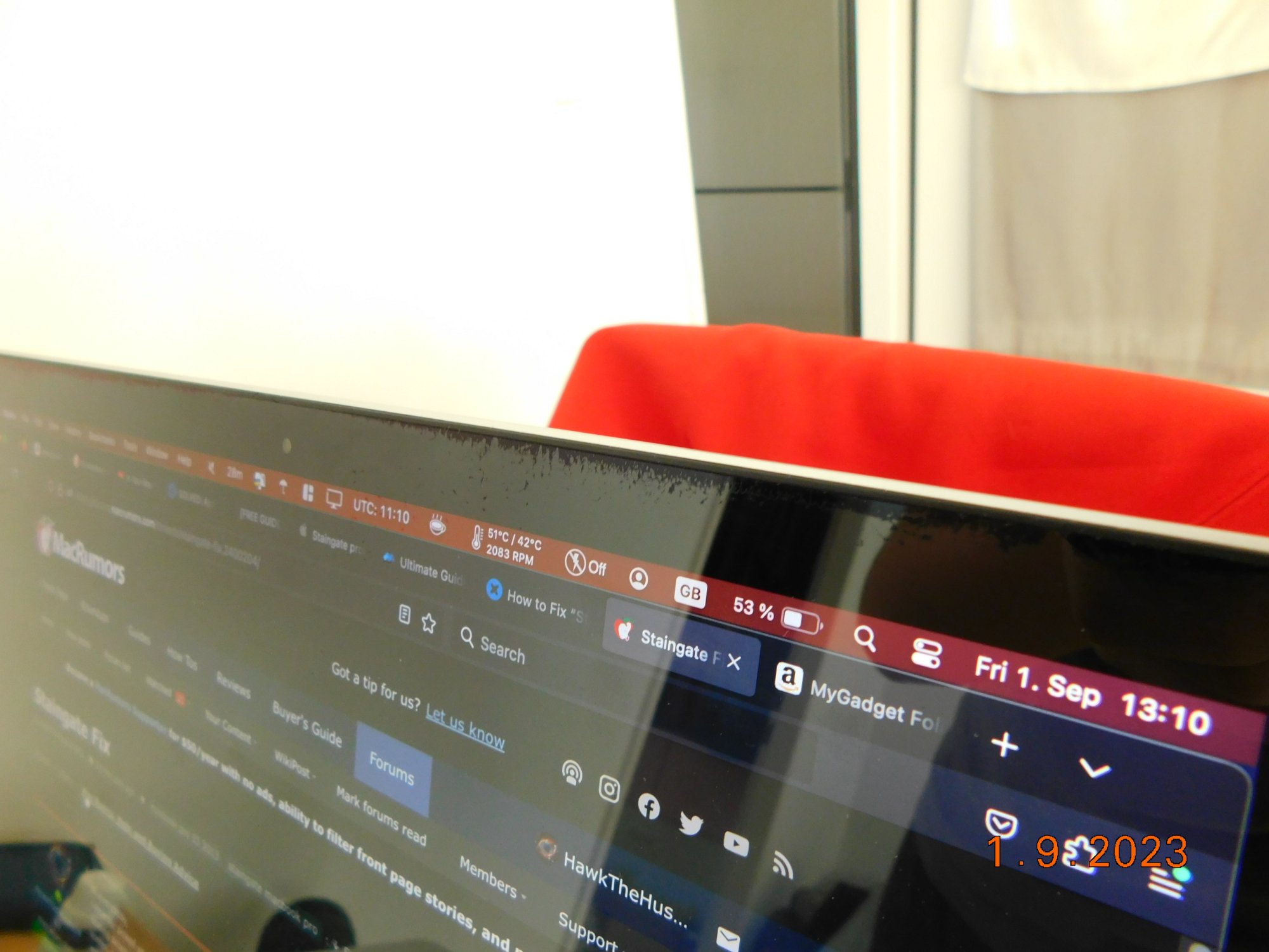

i recently picked up a late 2013 MBP 15 inch. I love it, but the problem is that it has the infamous Staingate screen protective coating delamination issue. I want to fix it because it annoys me, but not THAT much, because its mainly on the outside of the screen, not on the actual viewing area, but there is some on the actual viewing area, but i still want to fix it if i can, but i dont want to pay a lot of money to get it repaired by Apple, and its not eligible for a free repair by Apple i think. So, i have to fix it myself. Ive looked online and there are numerous guides on how to fix this issue, but the main thing is, remove the original coating, and apply a new protective film. I just dont have a replacement screen protector, so i went online to look for one that i could get. I only found one on Amazon that looks somewhat decent, but its a small company, the reviews are mixed, and doesnt look very high quality and apparently affects the screen clarity by about 10 percent. Or would it be ok? I want to get a high quality coating, and one that degrades the screen clarity as little as possible,while also being relatively inexpensive. Too much to ask? Idk. I just cant find a good one here in Germany.
So, does anyone know any good places/brands that sell good screen protectors for my MBP to replace its original coating? Or do i just have to put up with the screen issue? Can i still get it fixed by Apple for free or for not so much money?
Some pics showing the extent of the issue.
thanks in advance,
Nicolas

So i should probably just put up with it, because it doesnt bother me THAT much? Because i dont want to spend 400 bucks on a machine i got for 270 bucks lol. Does it look acceptable?
The partial staining on mine looked bad to me so I just removed all of the coating.
i know...it looks horrible. I think i either put up with it or remove the coating and apply a replacement coating myself...which option do i choose?
If you think it looks bad, remove the coating. If you think it’s then too reflective your options are to buy a display assembly from eBay and replace it yourself, which isn’t hard to do with instructions from ifixit, or try an anti-glare screen protector. You are probably overthinking your $270 laptop.
