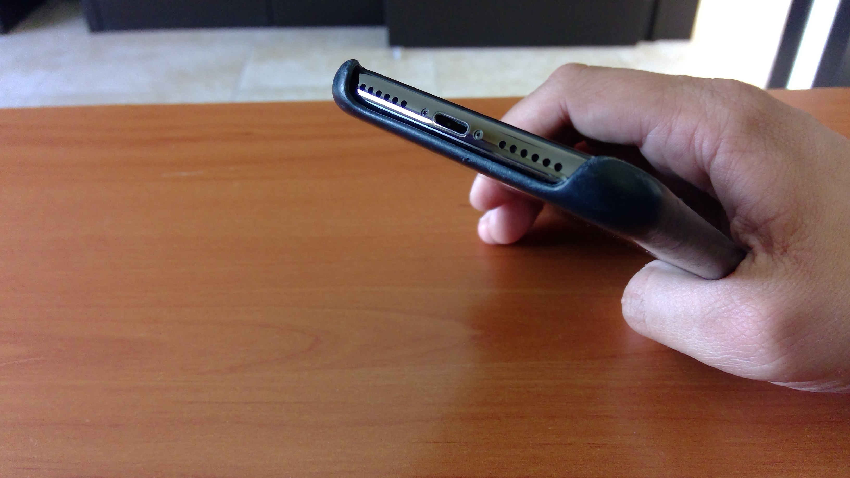

Has anyone experienced some discoloration in the iPhone X in the Stainless still band? It seem like a oil stain but it won't go away.
Sorry for the picture quality, the best I can do with my Surface Pro 4

To me, that doesn’t look normal and seems somewhat concerning. Especially being the near the lightning port like that, it almost looks like it’s rust or some type of corrosion on the bottom of the stainless steel. Or, if some type of heat was transferred on the bottom of the phone while charging and it got warm, and discolored the stainless finish.
Yes I thought it looks like heat as well. I use the Belkin Boost Up Pad that was announced with the iPhone 8 and X and the Apple 12W USB adapter, with an original Apple cable.
Most of the time I used wireless charging, while I only use the USB adapter when I need to leave and I'm low on battery.

Go to apple store and say the iPhone got very warm during charging and this happened. Apple store hates fire and will give you a replacement phone.
Unfortunately I don’t have any Apple Stores in my country, just authorized service providers. I will go to one this weekend and see what response I get.
Sometimes something like this can be stated more as a question than a statement, and the end results can be the same.
Point is, I think the OP is the one that makes the differentiation of what really happened versus somebody telling them or insinuating what may *not* have happened due to the discoloration.
Looks like burn-in from a lot of heat. You may need a new cable. I hate using Apple cables because they tear up so easily, but you don’t want to use just any cable either. Plus there’s wireless charging now. Hopefully there’s no internal damage.
As an aside, it also looks like you have some serious corner cracks or scratches from the lines extending around the speaker holes. Hopefully not contributing to the issue.

It almost looks like an electrical burn mark to me. I would return to the Apple Store in my opinion.
It’s worth noting, someone else had something similar happen to their iPhone when they had a power outage, and then they found the bottom of the lightning port had a bunch of discoloration from the heat during the outage that was caused from the electrical port. I’m not insinuating that’s what happened here, but could be a possibility.
That is just a reflection..... No scratch there. But agree it looks like a lot of heat.
The cable is in mint condition and barely use it, most times I use wireless charging. Never have found the phone to feel hotter than any previous one and the battery health still says 100%, despite it being purchased in early December.

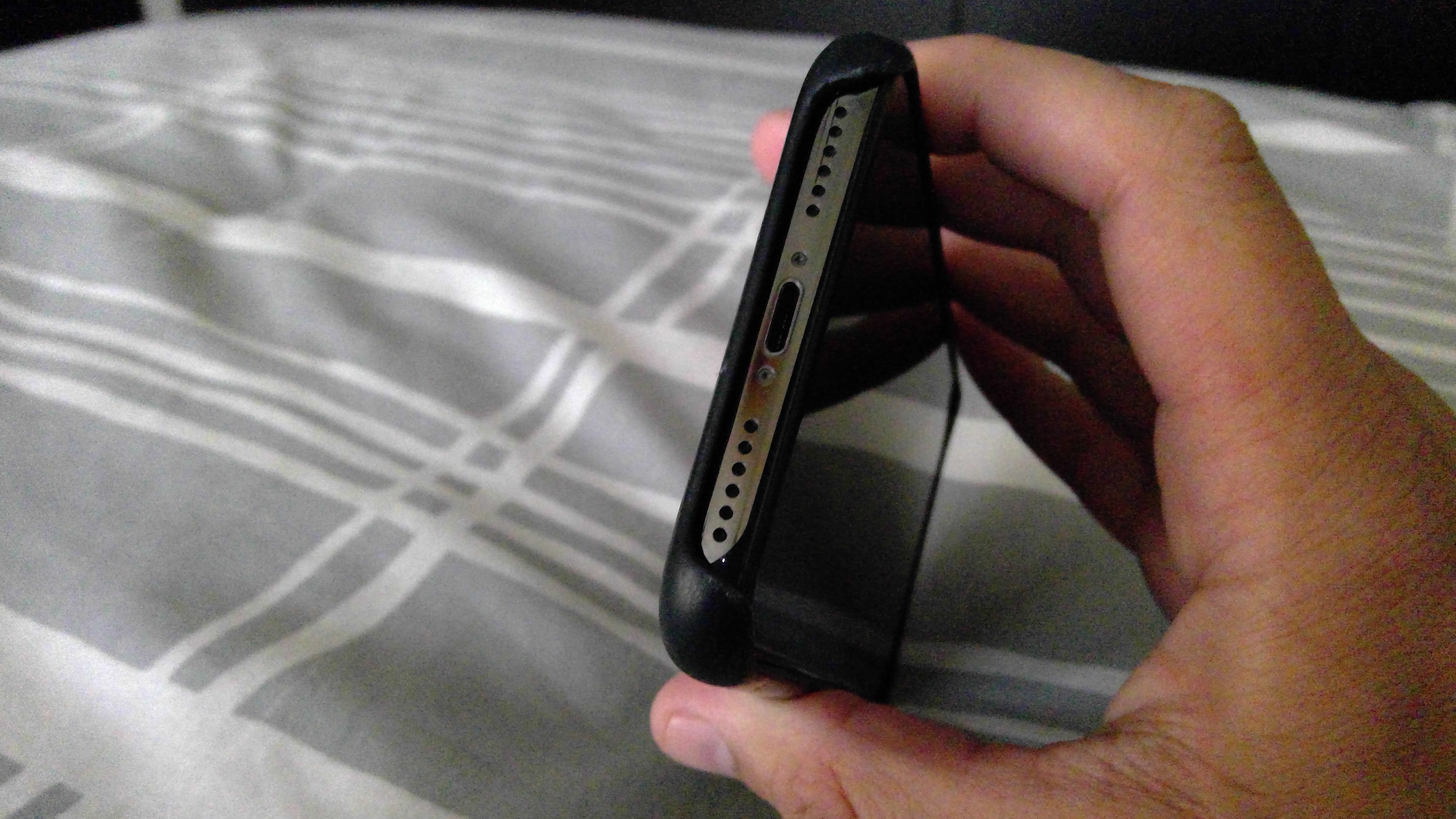

A new pic with better lightning. Under most lighting conditions is barely noticeable, but this represents more accurately how it looks most of the time.

Stainless steel is known for its corrosion resistance in many environments in which carbon and low alloy tool steels would corrode. The corrosion resistance is a result of a very thin (about 5 nanometers) oxide layer on the steel’s surface.
Note the word resistance - and the location of the color change.
Fingers and chemical on the outside of plastic charger cords
there are ways to clean and get the oxide layer back but I would not want to do that close to speaker and the charger
port.
as to heat and color
The table below represents the temper colours that are likely to form on stainless steel type 1.4301 (AISI 304) if heated in air.
Colour Formed Approx Temperature C
pale yellow 290
straw yellow 340
dark yellow 370
brown 390
purple brown 420
dark purple 450
blue 540
dark blue 600
and 232 C is when paper starts to burn

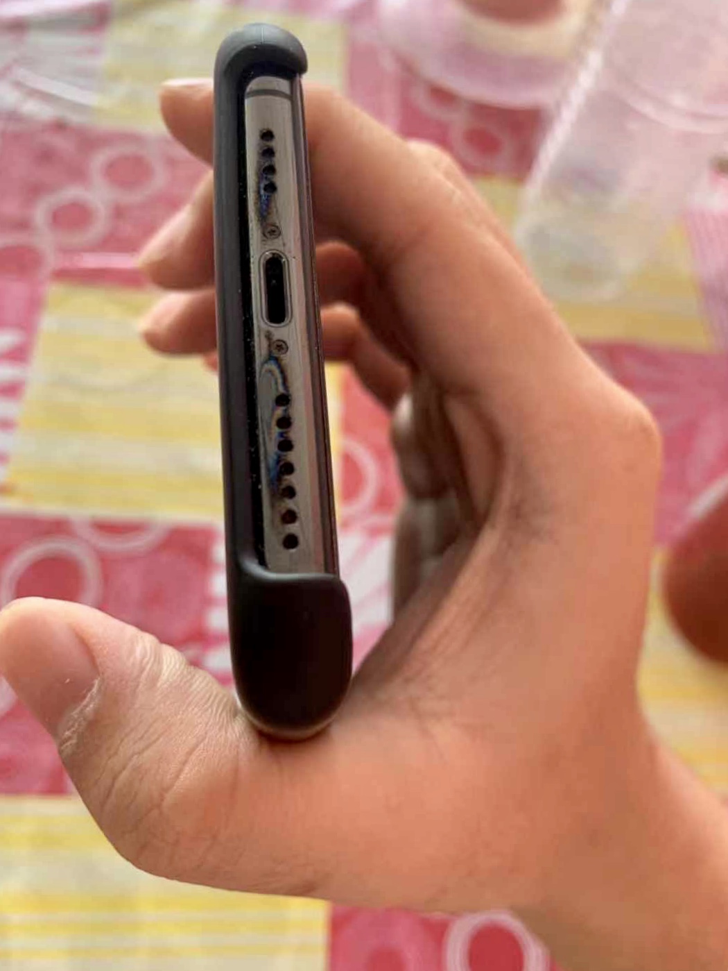

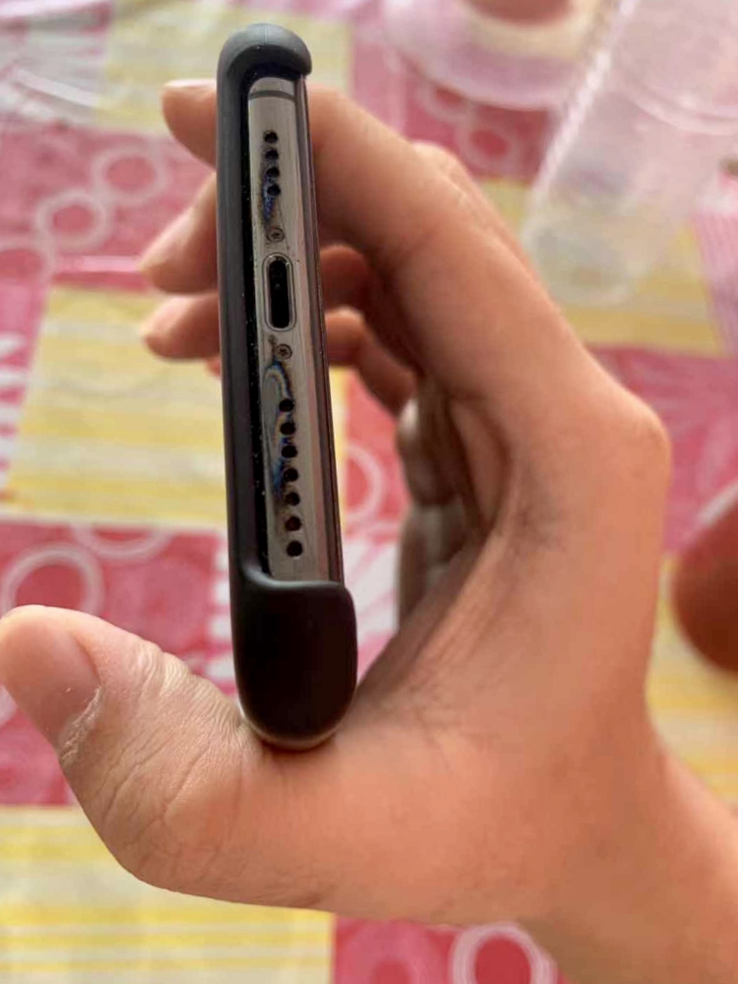

Yes I have the exact problem of this kind of "burn mark" after few month on my iPhone XS MAX, Apple been replace my iPhone twice and its the same, and I notice that many users that faced this kind of problems have Apple case on it. Hmmm

Looking at your picture, something either came into contact with the bottom of the iPhone grill area or it’s heat that’s being produced from your charger, which is discoloring the metal like that. That’s *exactly* what stainless looks like when it’s under a higher temperature, it starts to form a rainbow-like color. Are you using an Apple certified OEM charger? This isn’t anomaly, there’s something happening to cause that type of reaction on the bottom of the iPhone like that.
No way I would put up with that if in "fact" it is from normal use.
This it's another reason I don't like the oxidized versions of the iPhone. Too many instances of foolishness like this.
