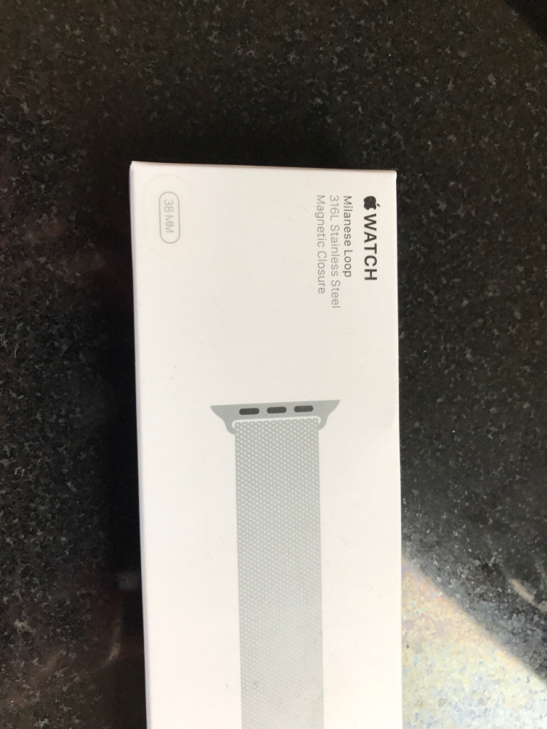

Milanese Loop is 316L metal...clearly written on its box.
You know, the way it's written the 316L SS Magnetic Closure could be taken as a description or the closure only. Not saying it is or isn't but the slightly different font could be telling.
The only problem is in how the band functions. The entire band has to be magnetic for the "closure" to work.
@Ixidor seems to know what he's talking about. Everything I've found searching the web is 316L doesn't have high magnetism. I see it's listed on the box @Thai shows in the picture but it's strangely missing from Apples website description where other bands have it listed. I wonder if Apple didn't weave in a metal with magnetic properties with the majority being 316L?
@OriginalAppleGuy
Since Apple did label the box as 316L, I wonder if it was a mistake or if it refers to particular parts of the milanese loop (like how the classic buckle, sports band etc are labeled as 316L stainless steel). However, this is very misleading for the milanese loop because people will expect marine grade corrosion resistance. I can't imagine Apple making a mistake like this though so there must be an explanation.
That being said, 316L can be rendered magnetic if a heat treatment was done to cause it to transform from austenite to ferrite/martensite (for instance, if you cool it to below room temperature). But doing so would cause negative impacts to corrosion resistance, which defeats the purpose of using 316L. Furthermore, Nickel, the element meant to stabilise austenite so the steel is non-magnetic, is quite expensive.
What makes me curious is that the loop is obviously very magnetic.
