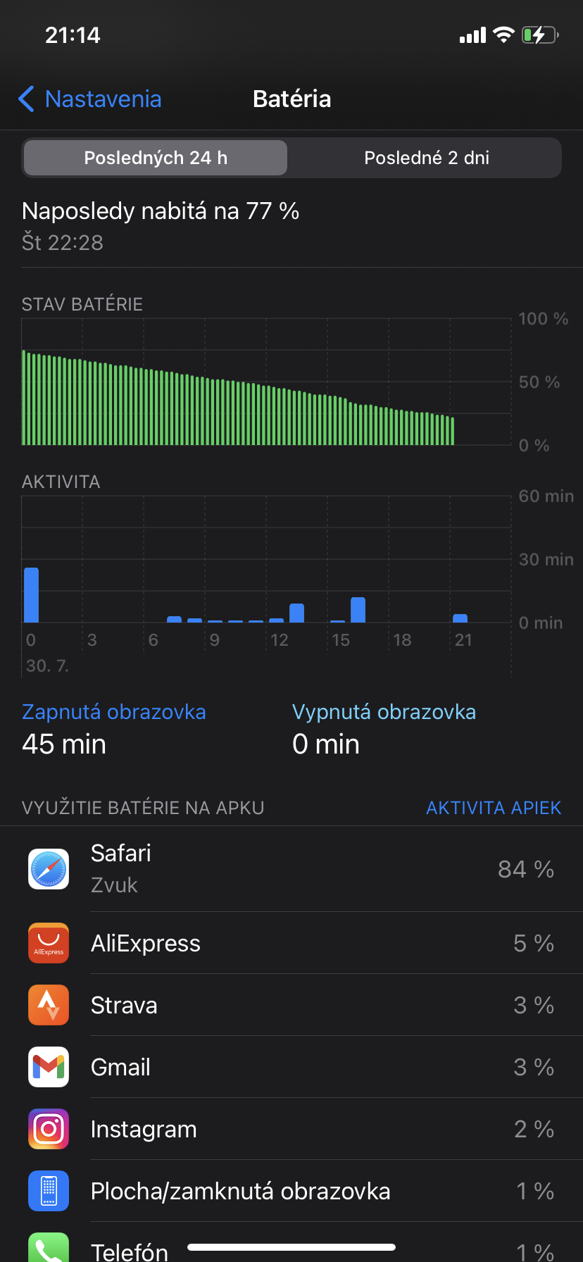

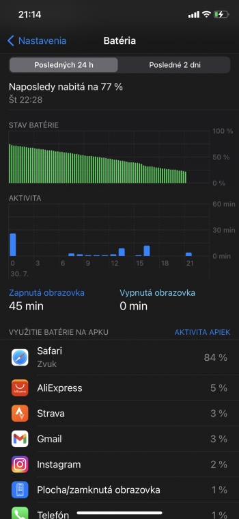

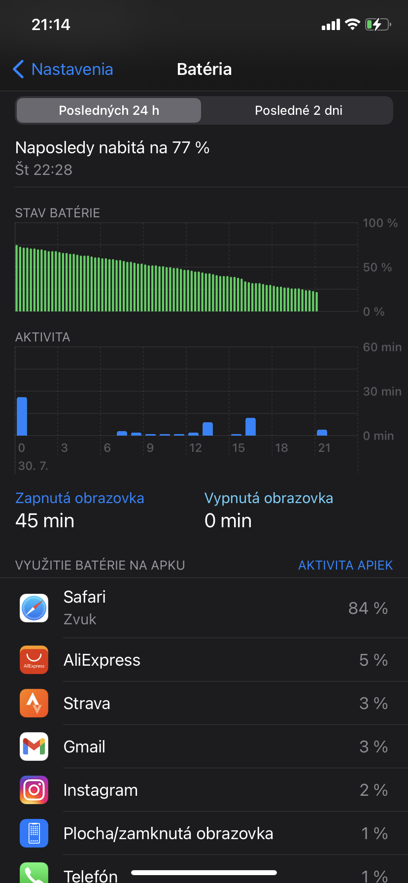

Hello,
I am getting standby battery drain on my iPhone XR. These days I am not using my phone a lot during the day, but the battery keeps drainig itself. I am attaching screenshot of battery screen. My battery health is 94%. I have tried DFU restore, restore via Finder, setup as new, Airplane Mode, Low Power Mode but still about 15% overnight drain and linear drain during the day. Does it mean that I have to replace the battery or could it be something with hardware or could possibly iOS 15 fix it?
Thanks.

How long have you had your iPhone XR? The battery in any iPhone naturally begins to deteriorate over time. Battery health of 94% would be bad if the phone was fairly new but for a phone that's several years old, it's to be expected, especially if the phone is heavily used.
Installing a later version of iOS is not going to help and would probably cause even more battery wear and tear.
Apple will replace the battery in your XR for $69. Be sure to make an appointment first.
I have bought it in September 2019, but I had older iPhone 7 and know people which have older phones at lower battery health and it does not drain the battery so much.
The XR first went on sale in September 2018, so it's difficult to say when your phone was manufactured or how long it was on the shelf before it was sold.
I don't believe the drainage you're experiencing is abnormal. A phone with deteriorating battery health is going to drain faster.
Take your phone to an Apple store and have them check it out and perhaps get the battery changed out at the same time.

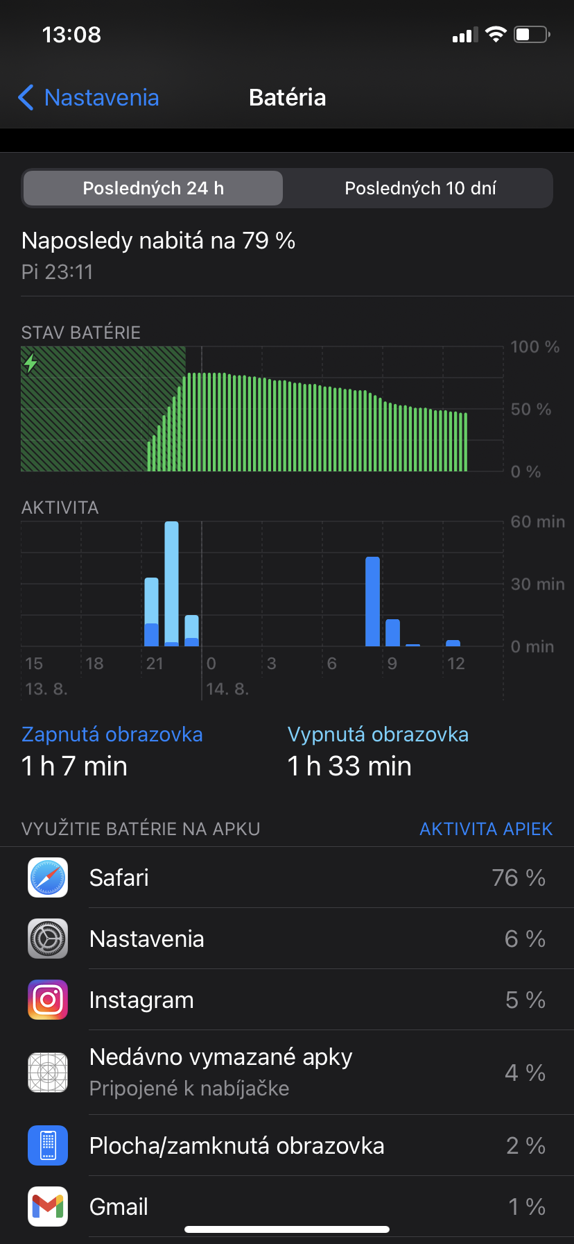

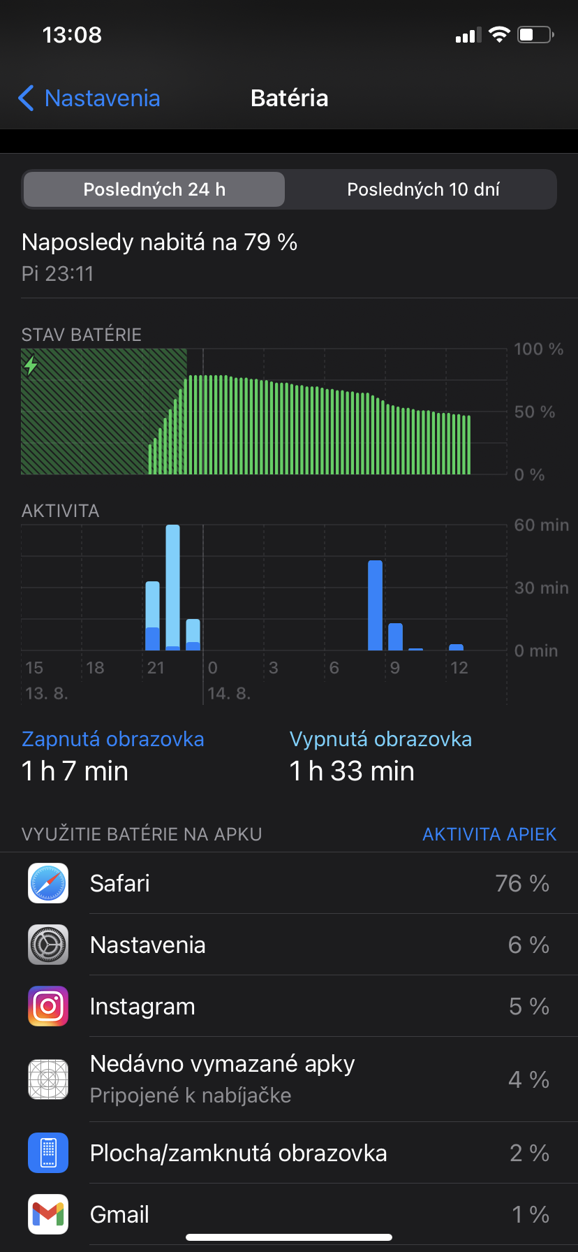

I would like to update this thread as I have my phone back from repair. Authorized service center offered me replacement unit without knowing what is faulty on phone. I suppose they could not find the problem with diagnostic. I told them to replace battery with a new one so I am attaching the battery graph till now with new battery. I think it seems pretty same like with the old one. That must mean that it was not battery fault.
My questions are:
Do I need to wait few days after restoring from iCloud backup?
If it does not help, should I try some type of reset like DFU, via Finder and restore if it helps now or wait for new iOS?
If it does not help, should I charge the phone from 20-100% or keep it in 20-80% to keep it as healthy as possible?
Thanks for advices.

You have a lot of apps there for such low SOT - do you force close apps** and turn off background refresh? I see both cellular and wifi antennas running - have you tried the wifi-calling feature? Are bluetooth and GPS antennas turned off when not using? How many antennas are running while overnight/sleeping? Is the motion sensor constantly running (counting steps in health app; or lift-to-wake)? Is the microphone constantly listening (‘Hey-Siri’ feature)? Are you using 2.4 or 5GHz wifi; Etc, etc, etc.
These phones are packed with features by default, and while they should be reasonably power efficient, if there’re any glitches in the hardware or software for ANY of them it’s going to show up in your battery/runtime… and not always on your battery graph**.
Sounds like you’ve really tried everything. What I suggest is to go through all settings and turn-off as many features that you don’t: know, use, or care about. Then charge to 40-50%; turn off all antennas; do a hard reboot**; do not open any apps; and let it sit overnight. This is just to see if you can establish a stable battery overnight (should only lose a few %) with as much as possible shut-down.
If the batt is stable overnight, then I would turn-on features, apps, antennas INCREMENTALLY to zero on the problem. For example, next day only use cellular and phone app, if that looks normal, then add safari the next day, and so on. If cellular/phone performance is bad, than go back to the hard reboot step and try only wifi-calling the next day. Etc, etc.
FWIW, I’m a big fan of undercharging batts for long life (see my 75-25 thread below).
** Sometimes force closing apps does not stop rogue background processing and hard reboots are necessary. THIS was my Reddit drain problem, solved by a hard reboot and Apollo.
Good luck.
