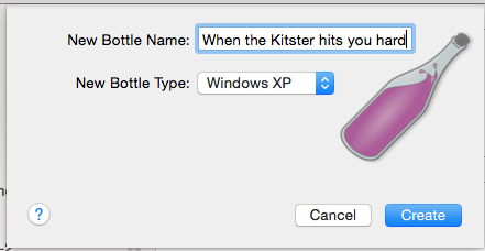

1) Open CrossOver, and click Bottle>New Bottle
2) Name what you'll be calling the app. Use Windows XP.

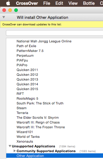

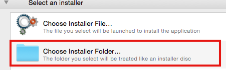

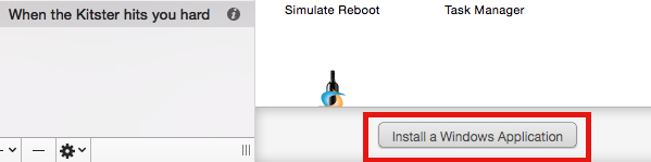

3) Click 'Install a Windows application'
4) Scroll down to 'other application'

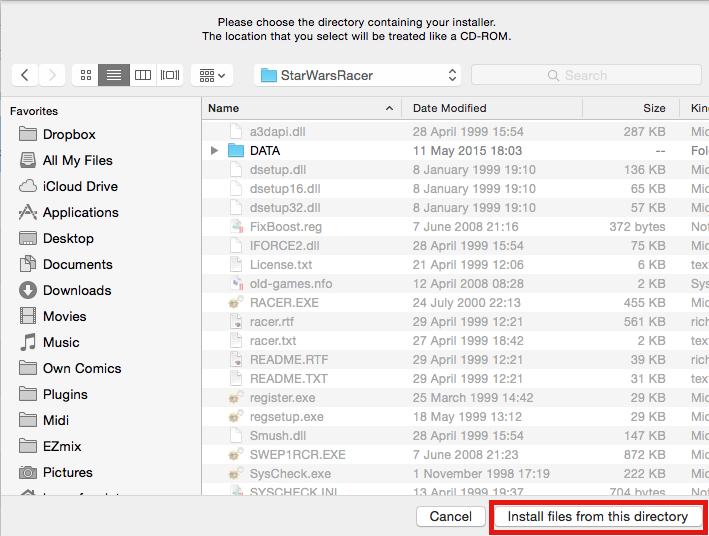

5) Click 'Choose Installer Folder'

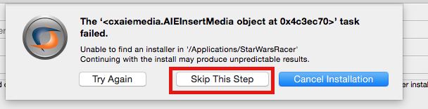

6) Navigate to the Star Wars Racer folder in your Applications folder, and click 'Install files from this directory'

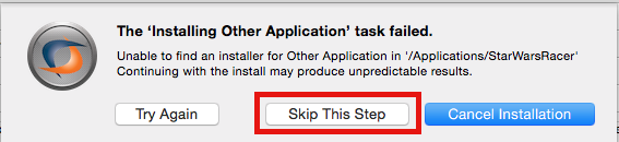

7) You'll get this error. Click 'Skip this Step'.
8) Another error. Again, click 'Skip this Step'.

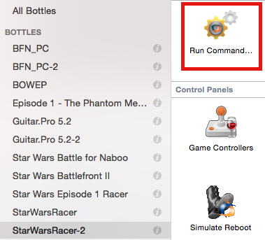

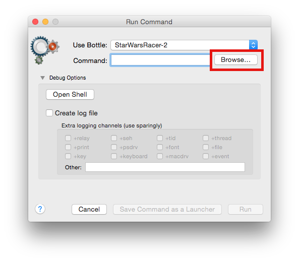

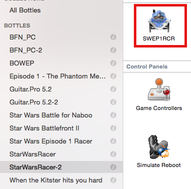

9) Once that's done, it'll take you back to the splash screen. Single-click the bottle you created and click 'Run Command'

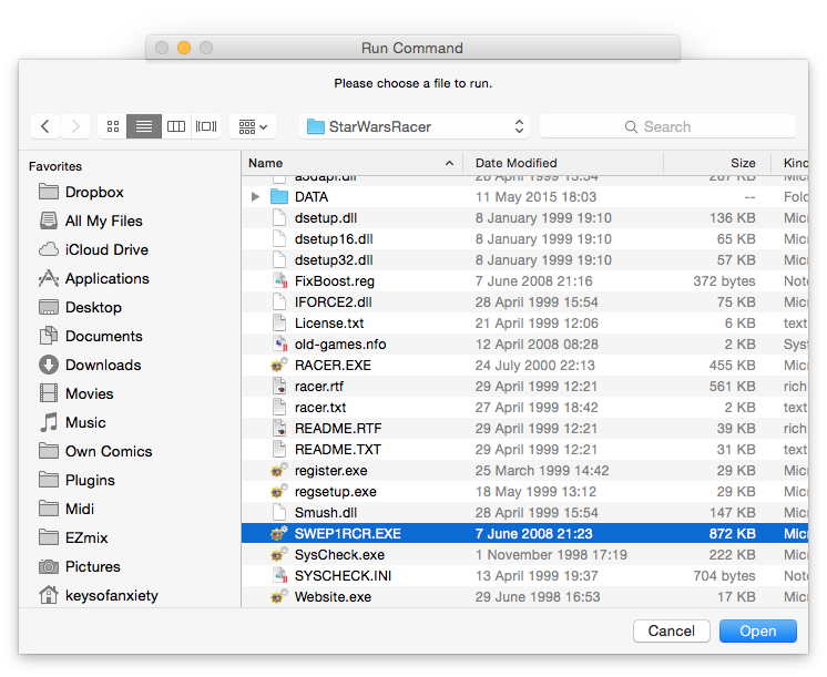

10) Navigate back to the Star Wars Racer folder in your Applications, and select the 'SWEP1RCR.EXE' file.

11) Select the SWEP1RCR.EXE file.

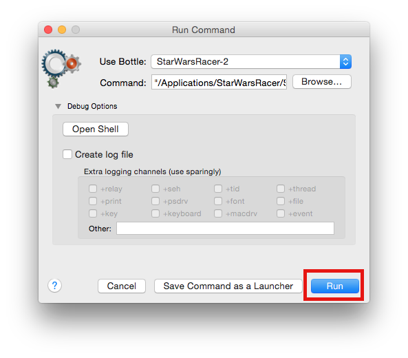

12) Once that's done, click 'Run'. Should work fine, hopefully without the blue bar freezing. Give it 10 minutes for the first run if you're not using an SSD.
13) Click 'Save Command as a Launcher' and click the red 'X' at the top-left of the 'Run Command' window to close it. In about 10-15 seconds, it should create a new icon to run the game.
