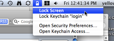

A more "sure" way to make it happen is to turn on Keychain Status in your menu bar.
/Applications/Utilities/Keychain Access.app -> Preferences -> Show Status in Menu Bar.
Took me a little getting used to, but it's my preferred method of screen locking now.
EDIT: Silly me, I just assumed that everyone used the screen saver lock to protect their Macs.
