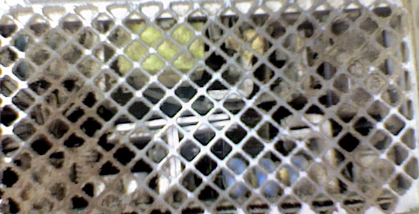

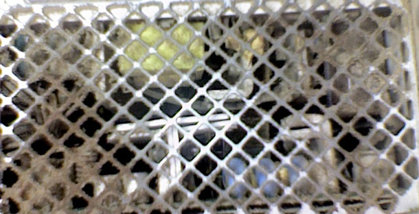

filthy psu
thank you, 666sheep! big help. i'm wondering if this mess might be a contributing factor? any word on how to test the molex (what voltage is correct? where to put the probes?) would help too.
