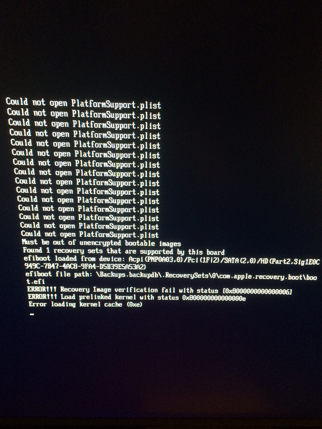

So I hope this is the right place for this. Looks like an old thread.
I have a 2009 Mac Pro. I desire to make multiple upgrades to this system. So I updated to El Capitan and did so on my Samsung EVO 500GB SSD. Then I partitioned half of it for Windows 7, now a Windows 10 bootcamp. This worked fine for me several weeks back.
I then wanted SATA 3. And why not! So I installed a SATA 3 Port adapter in my third PCIe slot. The system booted fine then all of a sudden every time I turn it off and on again I get that darn Circle Slash/ Prohibitory Sign! I can get around it by holding Option and selecting Windows or Mac OS. They both boot fine from the boot menu. BUT why can I not let my system boot up without forcibly going to the boot menu. I am stumped after trying solve it on my own!
Is this due to my SATA 3 PCIe port being seen as an "External Drive?"
Is this due to both Mac OS and Windows booting from the same drive?
Things I have done:
1. All drives checked with first aid (No issues)
2. Completely rebuilt El Capitan's boot files with an huge install file. No difference.
3. PRAM Reset. Got me into MAC OS just two times and then Windows once (with now force to boot menu!)... then back to the Prohibitory symbol.
4. Checked the Boot Readout behind the scenes. This is where the Prohibitory Symbol hits. (SEE ATTACHED PICTURE I TOOK)
I will try to reconnect the SSD to the slow internal ports just to see what happens.
Any advice? Thanks.

When booted into OS X, go to System Preferences–>Startup Disk and select your OS X partition there.
This might fix it.
Please report back.
This might fix it.
Please report back.
That is how I switch to the other boot partition in Mac OS. The error comes after I select startup disk in Preferences as Windows partition then system reset. I try doing the same in Windows with the Bootcamp tray icon to send me to Mac OS again but same Prohibited Sign... It is only when I hold option and force the boot choice screen that I can get into the other Operating System.
Another update:
1. Today I pulled out the SATA 3 PCIe ports and just connected my (WIN/MAC) Startup drive to the first hard drive connectors on the motherboard. Then PRAM Reset. Same issues...
2. I was worried that maybe my time machine backup drive was causing boot confusion in the system so I yanked that and still got the Prohibited sign.
I am still able to boot no problem with holding option and choosing the operating system.
That picture I uploaded in my previous post was the Verbose Mode readout when I get the Prohibited Sign. I can't make sense of it with google but maybe someone has an idea.
Thanks.
So odd.
Maybe the mach-kernel replacement from the attached link does the trick. I'm pretty sure you shouldn't replace the mach_kernel on the disk you're currently boot from so boot from some other disk. – And make sure the mach_kernel is the correct OS X version!
http://www.cnet.com/news/resolve-boot-issues-showing-prohibitory-sign/
[doublepost=1457601933][/doublepost]… or maybe reset PRAM again. It worked before and might again, hopefully permanently this time.
