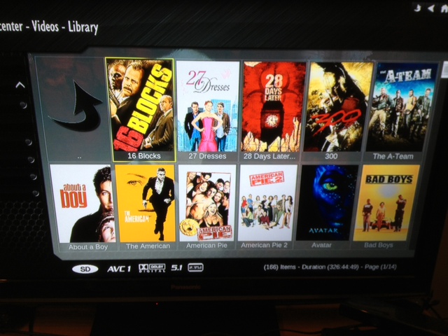

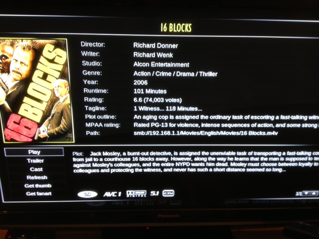

hmm...that sounds pretty cool. I read a little bit about XBMC. Are you saying use that program instead of iTunes? I already have plenty of external HD's and a wireless router.Is the only benefit of the ATV3 the ability to play Blueray rips in HD?
I haven't really look at ATV3's spec since its launch date, but I am sure it is faster than ATV2 besides its support for 1080. However, until it is jailbreakable, it really doesn't matter much beyond that it's 1080.
And yes, with XBMC, you wouldn't need a computer running. ATV2 with XBMC will essentially play all of the popular video formats directly from an external HD.
XBMC will also pull meta information and images from IMDB, not to mention the ability to easily download and play subtitles and captions.

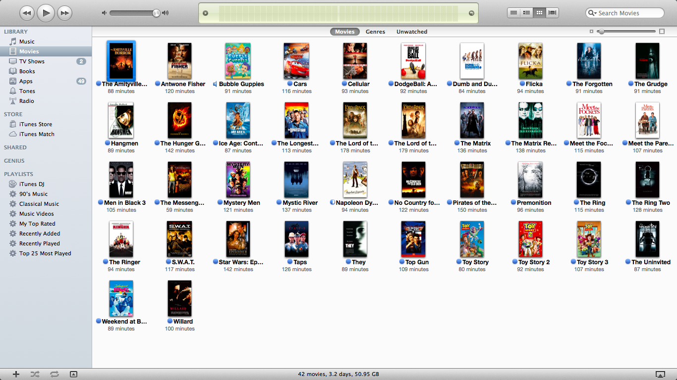

4 days of work...
