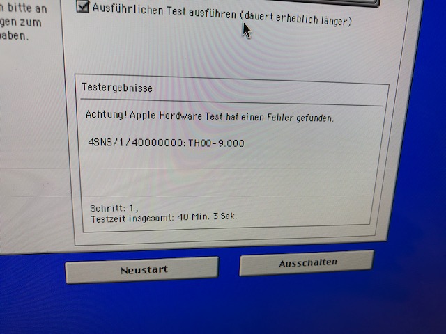

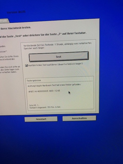

Apple Hardwarecheck brought up this error message : 4MOT/4/ ...................: HDD - 1243
So i replaced the internal HDD and the HDD Fan. Now there is one Error Message left, cause the system is missing the Temperature Sensor on the HDD (i replaced it with a standard and will use a software for the fan) : 4SNS/1/......: TH00-9-000

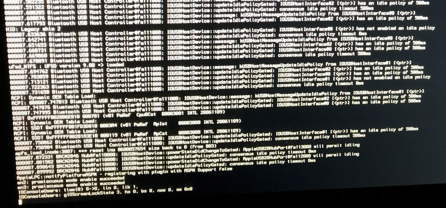

Problem with starting is still there. So i run Verbose Mode, please see picture attached.
Is there a chance to be sure if this is the very common GPU Problem on this Imacs ?
Has somebody any Tipps for me what i can check also. Rapairing with TimeMachine Backup wont work also.

Hello,
i disassembled the whole iMac, removed the GPU Card, put it in a oven for 8 minutes on 200/celsius, then put everything back together and now it works fine again.
Also my iMac was caught after 7 years with a broken Graphiccard.
Hope this helps ;-)
regards
Fredi
Well done Fredi, good to see your hard work rewarded. Done the same oven trick on my three imacs - still running fine after 6 months.
