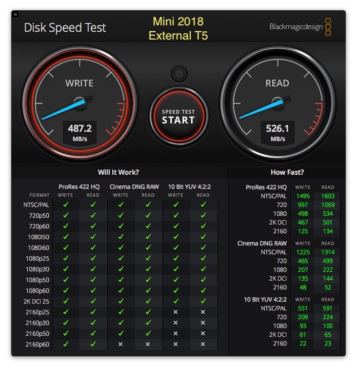

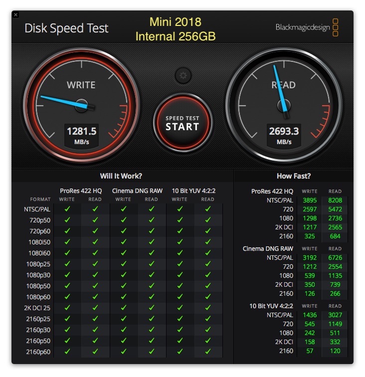

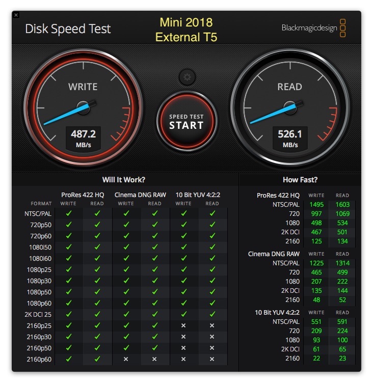

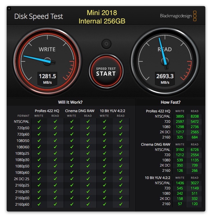

I was planning to boot my 2018 i7 Mini w/ 256GB SSD from my Samsung 1GB T5, until I ran these speed tests...
GetRealBro

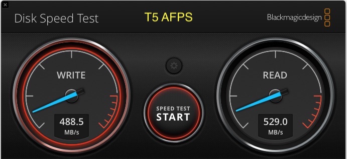

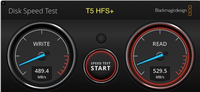

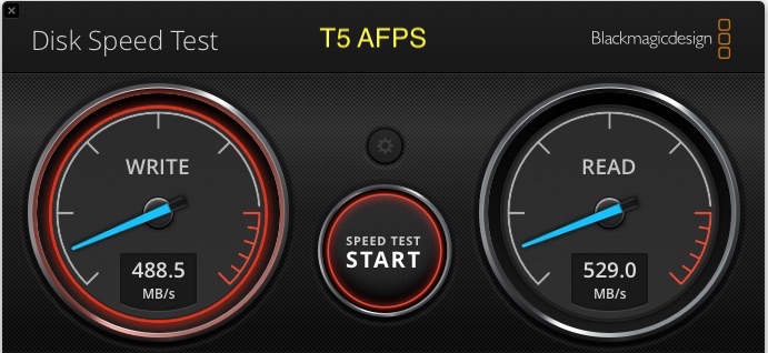

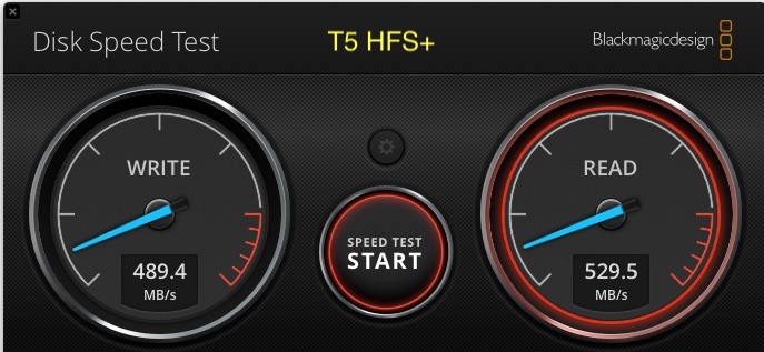

My T5 is attached via USBc and partitioned into: System (256GB AFPS) and Data (744GB HFS +).
Could you post R/WR speeds from both partitions of the external drive? I am curious if there is a significant difference between the two file systems.
System: i7 Mini running Mojave 10.14.6 on the internal 256GB SSD. Targets: Samsung T5 connected to USBc port with two partitions: AFPS and HFS+
GetRealBro

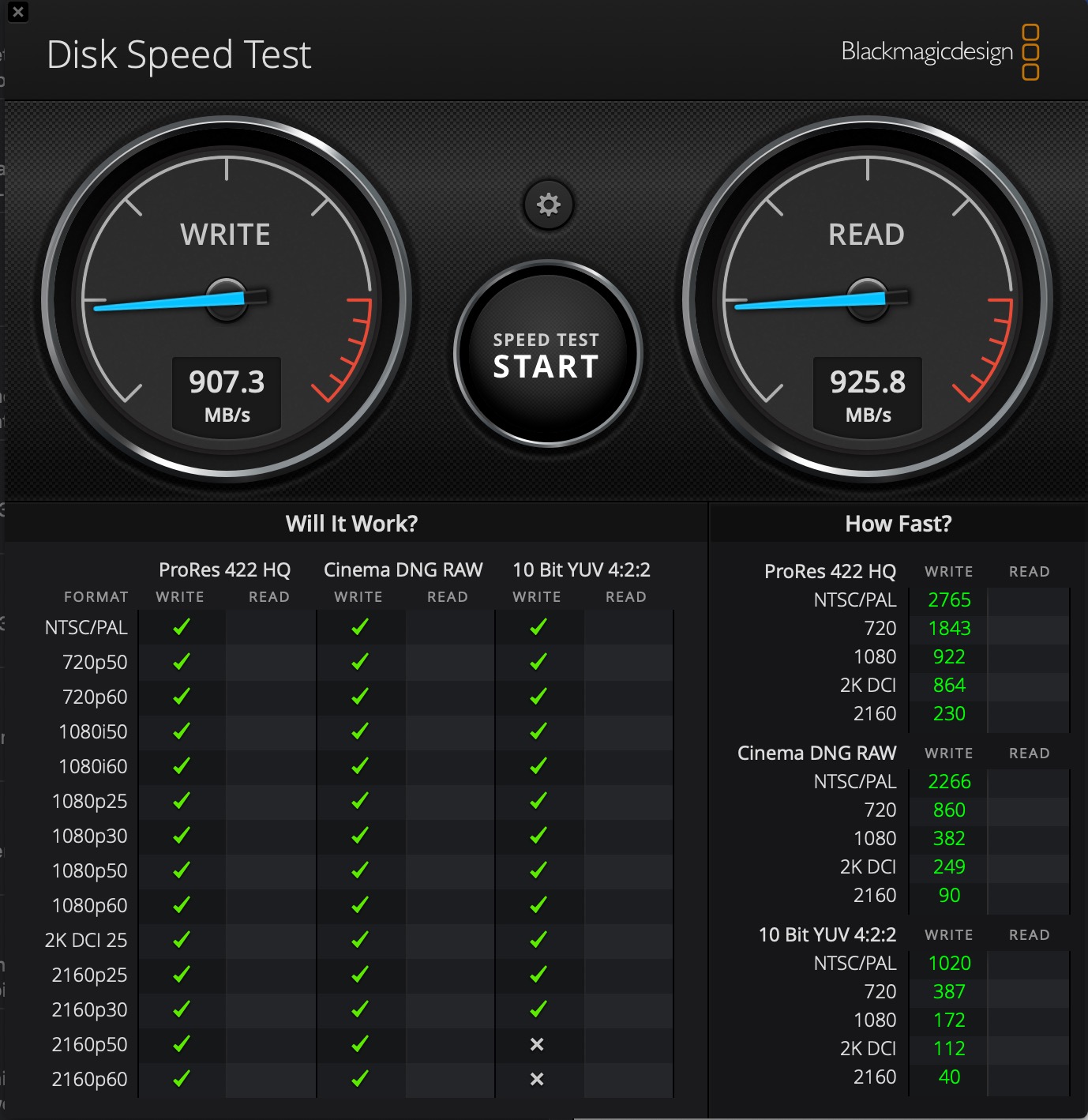

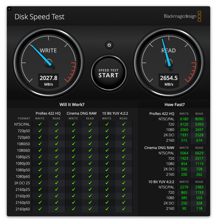

The attached screenshot is my external APFS-formatted drive with USB-C connection. This is with an external X5 enclosure as discussed in this thread here. Soon there'll be other Thunderbolt enclosures available.
@getrealbro Seen your diskspeed screenshots. Very strange that your T5 is so much slower than my 'no-name' enclosure.

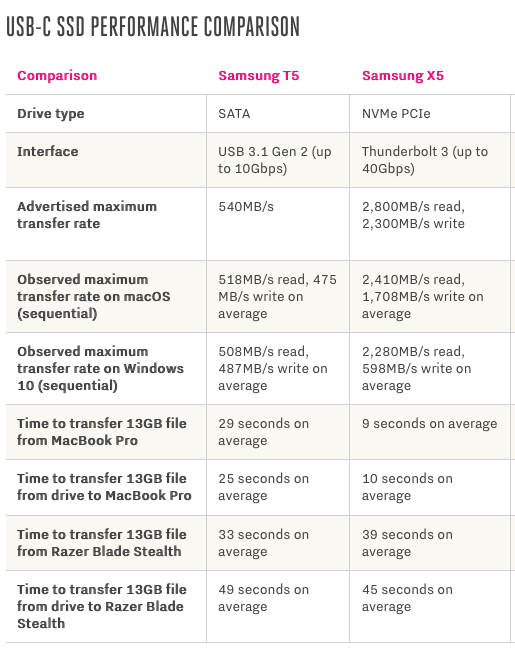

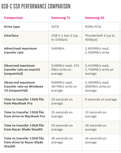

It’s not clear to me exactly what “1TB Samsung m2 drive,”you have. But I’m guessing it is an NVMe PCIe SSD. If so, it should easily beat a Samsung T5, which is a SATA SSD and only advertised to get 540MB/sec. So my T5 is performing very close to spec. And your "1TB Samsung m2 drive" in a "no-name" enclosure is getting 40-50% of the performance of an X5.
Attached is a table which compares the Samsung T5 (SATA) and X5 (NVMe PCIe) SSDs curtesy of the Verge.
https://www.theverge.com/2019/5/13/...rbolt-3-usb-c-samsung-x5-t5-specs-test-how-to
GetRealBro
Ah, ok. Sorry, my bad. Didn't realize the T5 is SATA. I thought it's some sort of "smaller brother" of the X5.
