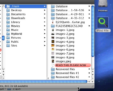

I use a simple tool called "Find File" (as OS X will not search in places I sometimes want searched) and on occasion I sweep the invisible trash folders of "suspects". Here's a screen shot that looked for ".trash" and found a few files. This particular server has almost 300 home directories, so i have to keep an eye out so the kids don't fill the server up with dmg's and mp3's.
This may not be it, but it's worth a look perhaps.
I'd also erase free space with disk util, and replace the directory with DiskWarrior, which has saved my bacon on more than one occasion.
Also, try inventorying your disk to see what's what with
http://www.derlien.com
If that shows no anomalies, I'd do DiskWarrior next.
