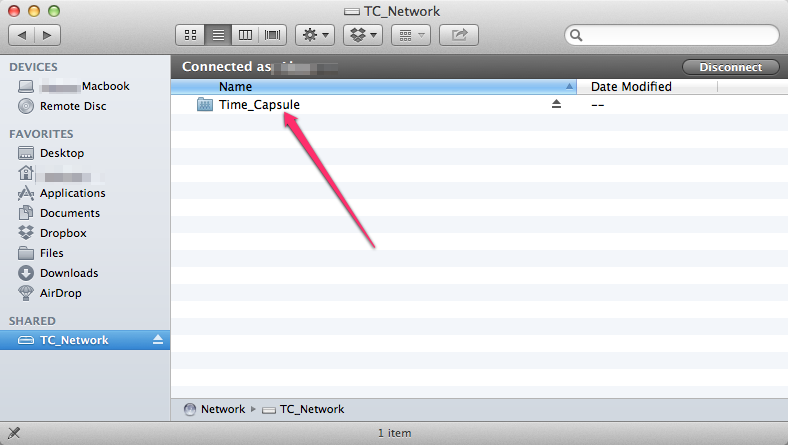

Just to clarify, I meant use Omni on your main, internal drive.
But no, by default the TC drive won't show in Disk Util. You can get the sparse bundle on the TC to show in Disk Util by mounting it.
Select the TC on the left there under shared, then double click the folder I marked. Yours will be named differently.

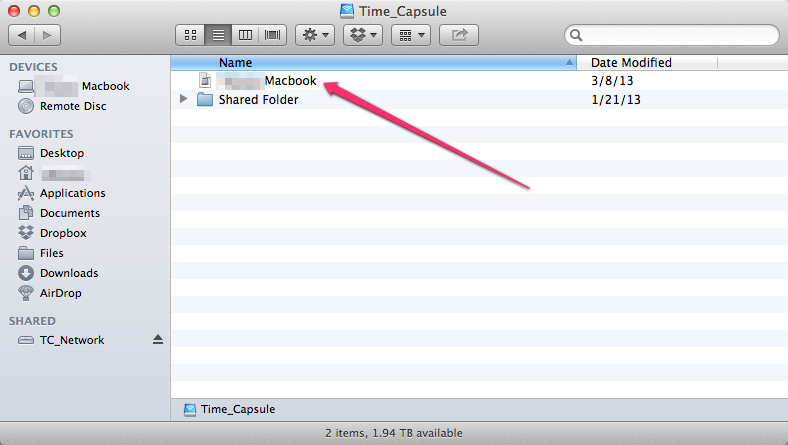

You will get this in Finder. Now double click the sparse bundle like I marked. That will mount the sparse bundle and you can see it in Finder and Disk Util.

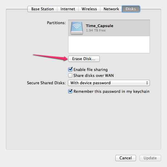

So I got the sparsebundle to mount and attempted to repair the disk via disk utility and it failed. It told me to back everything up and try to erase the disk. I'm wondering if I should just try to erase it and see what happens. I don't necessarily need anything that's on the drive right now since I also use CrashPlan but I'm not sure if it's just going to be a waste of time. It seems like the drive is shot at this point.
It just takes a few seconds to erase the disk in Airport Utility. It sure seems worth a shot.
Thanks Weaselboy. I was able to erase the disk but my time machine backups are still failing. I'm going to try to repair the disk again via disk utility and see what happens.
