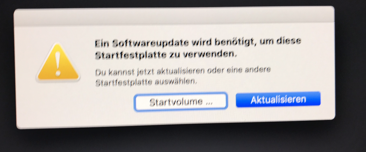

I am booting macOS on a 2018 Mac Mink from an external Thunderbolt NVMe drive setup. From time to time a message pops up, saying that the startup disk software has to be updated. After this update process the boot continues as usual.
What exactly is going on here? And why does it happen more than once?

" A software update is required to use this startup disk." Then you can click on the "Update" button and it starts the update process (like firmware update).

Yes, it is an old installation and it just worked. Security is already disabled in the T2 settings.
Do you know what exactly is being updated in the process?
I’m not sure what it’s doing, but I saw this a couple times when I was first setting up my mini which uses an external boot drive from my old computer. I let it update each time and haven’t seen it again since.
Do you mean the process of reinstalling the macOS system?
The reinstall checks everything that is installed, verifies that all system files are present, and in the correct location. Any discrepancies are fixed. Part of that is verifying that the drive format is correct, and valid. THAT should fix your issue, I think.
What does the reinstall actually update? Everything that needs updating, or replacing. That could be thousands of files, or just one file in the wrong location. It is essentially a "repair" install of the system.
If your external boot disk is NOT in APFS format, the Mojave install will change the format to APFS.
(The installer checks the format, and modifies it to APFS. You don't have any control over that. The installer will do that change automatically, and that is likely a fix to prevent that message about updating the software.
