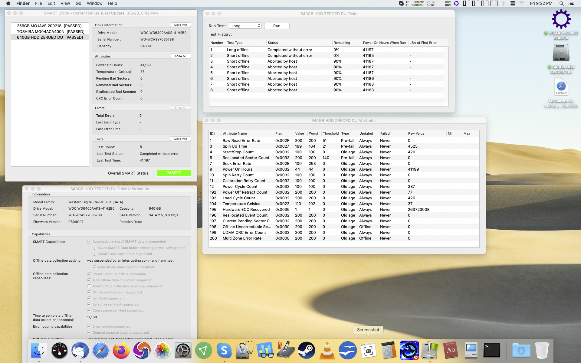

In case anyone is interested in what a real SMART report looks like run in macOS .
This is a ten year old factory installed Mac Pro 4,1 ( 2009 ) 640GB mechanical .
It's in pretty good shape and passed both its short and long tests .
41,000 hours of being powered on .
This is not an enterprise grade drive . It is a Caviar Blue WD .
macOS SMART tests are not as sophisticated as the better Windows and Linux utilities , though .
Is that using the SMART Utility app? Been using that for years on my PowerMacs.

It's a command line tool. Smartmon-tools is the reference app for SMART on Unix.
Brew has it.
