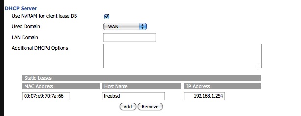

You can assign an IP to a specific machine while still using DHCP, normally it's in the router's advanced settings.
I do static DHCP with ISC DHCP on my server. Set the lease time to something really big (10 years) and then assign the mac address of whatever device I am setting up to use a specific IP. This worked best for me. It also gives me a nice list in the config file of what is what on my network. In my DD-WRT I believe, if I had it configured as a router (it is used only as an AP) I could also do this. I vaguely remember this type of setting in an old SMC router and a Belkin router I had awhile back for another location.
So you would leave the auto config in your laptop, and then have the router do the static DHCP settings. This should work with just about any router out there now.
