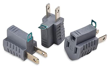

Have you tried using ground lift adapters? Seems counterintuitive but my setup (active speakers) had a noise once that disappeared when I used ground lifts.

Ground lift adapter:

Cheap and worth a shot.

I can't find one in local websites, Indian market that is. Also isn't this thing do the opposite of what should be done?
Besides my wxa-50 came with 2-Pin plug, so isn't that already ground lifted?
I have to read up a bit more on what these things do. I'll do it tonight.
I didn't know the amp was a two pin plug. You mentioned being in a gounded outlet in your OP.
A ground lift on the amp won't accomplish anything, in that case.
