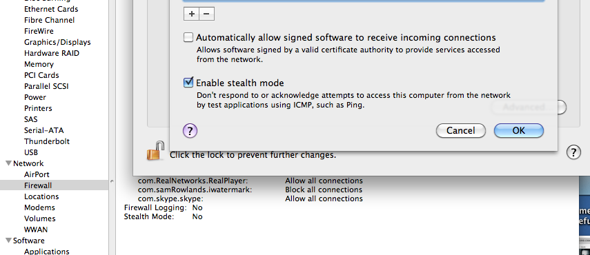

I enabled Stealth mode on my Mac Book Pro (2010 model) but when I look at the system details is says: "Stealth-mode: No"
What could I be doing wrong?

I tried the Shields up and it showed everything stealthed apart from FTP port 21.
Could anyone tell me how I can stealth this port too please?
I found that the FTP port was assigned to AIM (chat app). I disabled that completely and ran the GRC test again. This time I am stealthed on port 21 but still failed on something that was fine before:
Ping Reply: RECEIVED (FAILED) — Your system REPLIED to our Ping (ICMP Echo) requests, making it visible on the Internet
How can turning off FTP suddenly make me Pingable?
Down the rabbit hole I go..
