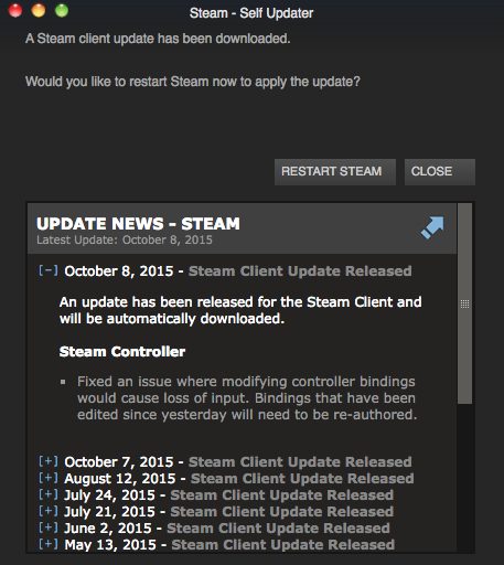

Hello,
Steam self updater keeps asking me to update, which I have done multiple times. However everytime I launch Steam, an OS X dialogue appears: "Steam needs to self-update before launching. Type password to allow this."
I do this and a second Steam icon pops up on the dock with the usual Steam updating... extracting package... then the second icon disappears and Steam launches as per normal.
Then again while running Steam it asks to update. I have been stuck in this loop since the update arrived 8th October.
I am running Steam build 7 October API: v017 on mac mini (late 2012) running Yosemite 10.10.5
Any help would be appreciated.
Thanks.

Hello,
Thanks.
Hi bmac89,
I had the same problem for my son's Steam on my mac mini. The steam app in my Mac user account (admin) never had the issue, but on my son's Mac user account (user) always had asked for my admin userid and password. Googling with no luck for a while, I looked through my hard drive where the downloaded Steam client patches are piling up and thought about the following steps to fool the steam app. It worked for me, although I do not know how long it will last.
0. Login to the Mac user account
1. Quit Steam
2. Open Terminal
3. Login as root (super user) su -
4. Go to the Steam's Application Support Directory cd /Users/<username>/Library/Application Support/Steam
5. Archive the package folder mv package package_old
6. Create a new package folder mkdir package
7. Quit Terminal
8. Open Steam
9. In the menubar, go to Steam>Check for Updates...
Viola!
Good luck! Hope this works for you, too.
