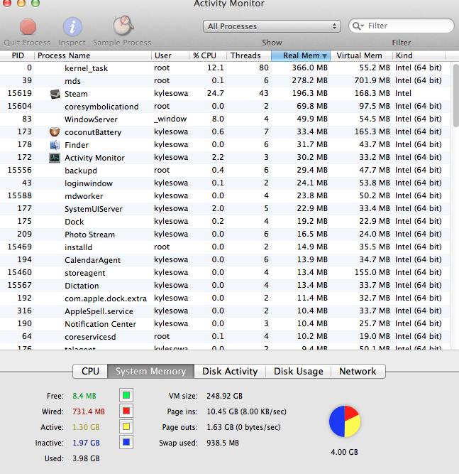

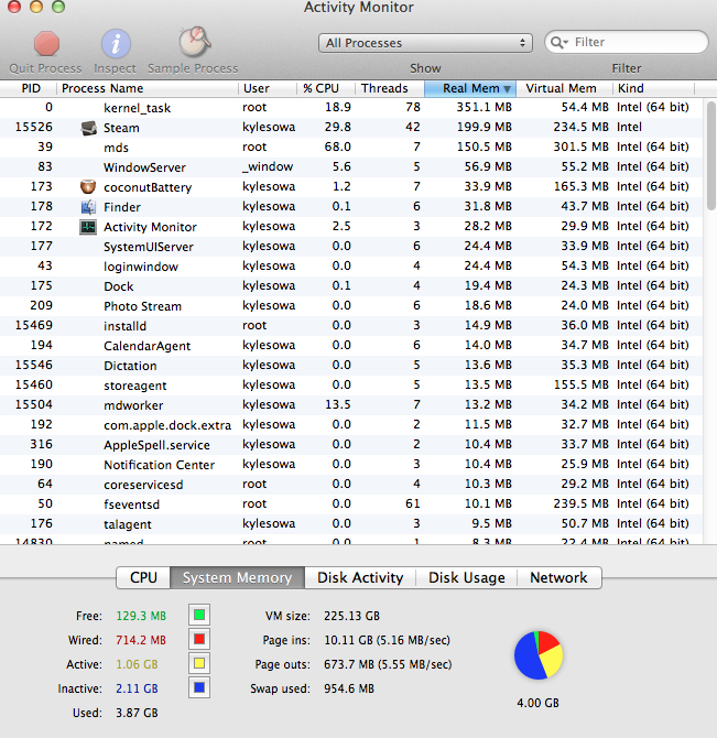

Every time I open Steam, it ends up reducing the amount of free ram into the Megabytes. These are two instances that happened when Steam was essentially the only program open.
I've already tried uninstalling and reinstalling Steam to see if that would help. Unfortunately this still happens. Is this a problem with Steam and its coding or is it a problem with my computer?
It's only using 200MB of RAM. You have a lot of inactive memory though. That should be treated as free RAM.
Some program allocate and use a lot of memory initially then release it right away hence inactive memory. Regardless, I don't think you should worry about it.
So shouldn't the amount of inactive RAM go way as soon as Steam is closed out?
When I have a lot of inactive memory I open up terminal and type "purge". I'm pretty sure it just frees up all the inactive memory. I don't know if there are any long time effects using that command though.

I've been using that command. Thing is that Steam will fill it back up right away. So I only use it when I close out Steam.

Blue/inactive memory will/should be freed up if something requests more memory
