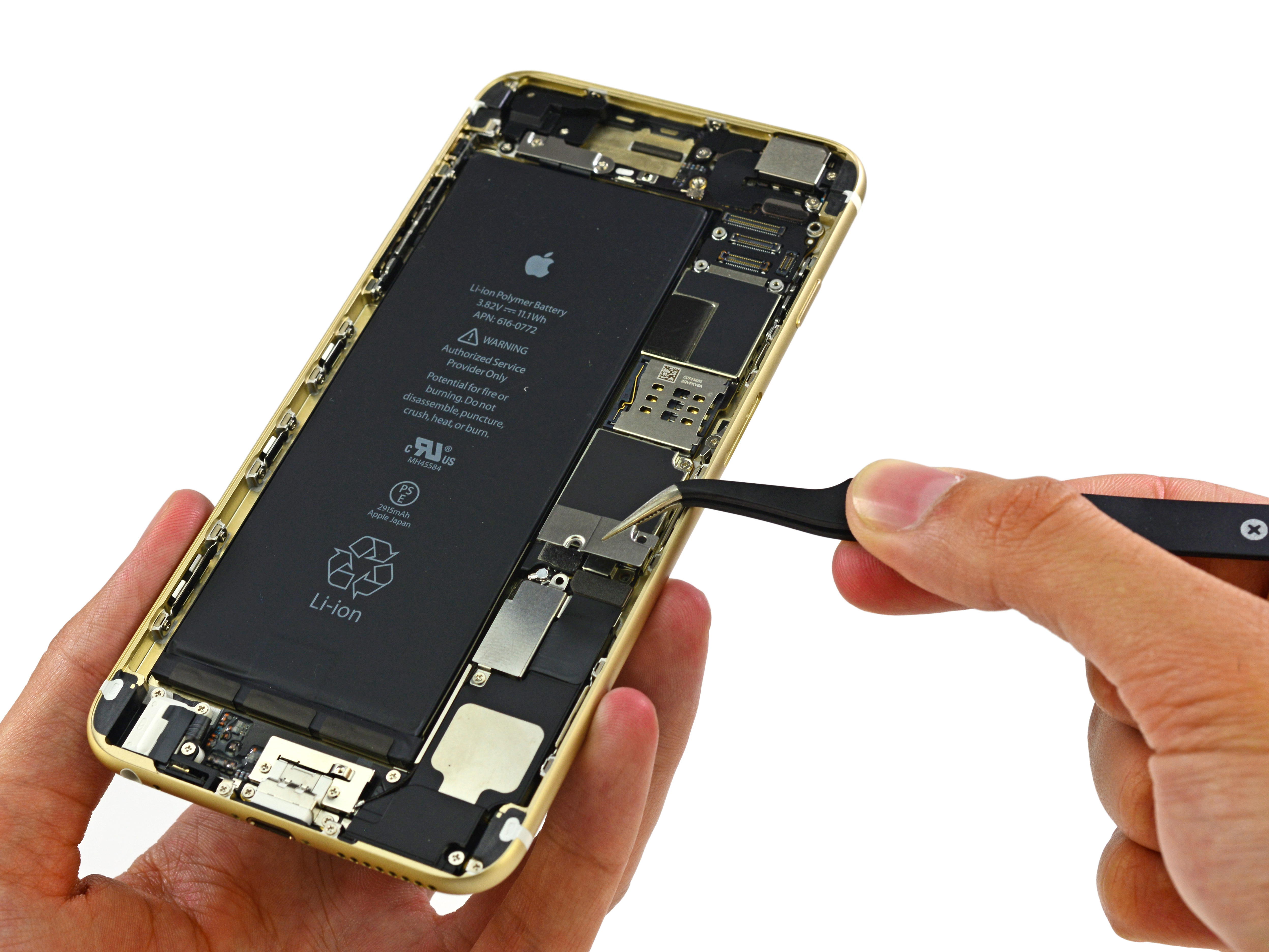

I looked at the teardown as well, and I think they may have meant the screw sets. Does anyone see anything?
I only see clip holders which do have some steel, but the gaps between them act like stress focus points.

OK. Looking very carefully at the photo from the teardown. Notice the volume buttons are place on a relatively thick steel bracket. Looks like the intent was to have this provide some structural strength to where the cutouts for the volume buttons are. This bracket appears to be held in place by 2 small screws that attach to the small black inserts. My take here is that probably what is happening is one of two things:
1. The small black inserts move upwards when the phone is subjected to pressure in this location thus effectively allowing the bracket to move reducing the support it gives the frame.
2. The screws holding the bracket are made of soft metal and they themselves bend or shear off when the phone is subjected to pressure at this location. Or it could be as simple as some assembly error where the wrong screws were used in a particular batch of phones.
Either way I think it's an easy manufacturing modification that can be made quickly.
The fact that these relatively thick brackets were used leads me to conclude that Apple recognized the areas with cutouts would be weakened and worked on strengthening them.
Just my 2c.

Inserts don't always mean separate parts. They can be embedded in the frame. The stainless steels are attached on the side frame though. I believe Apple already did through FEM analysis.
Look at the close up pic above. The inserts are clearly not machined out of the frame. The frame is machined with a c-section to hold the black colored inserts.
This bracket's main purpose to be a stop for volume buttons, but I agree, it kinda doubles as a strengthener. But because it attaches to the frame just by the ends, its end closest to the middle acts as a focal point for stress, where the soft "aluminiminium" almost snaps, as clearly demonstrated by the #bendgate video.
I agree. However, I think the designer's intent was to have it completely flush with the bottom of the frame. Notice, the machined pads for it to rest on. Should have gone the safe route and just made it 1/4 to 3/8 inch longer. That way it cannot "rotate" around the screw.
