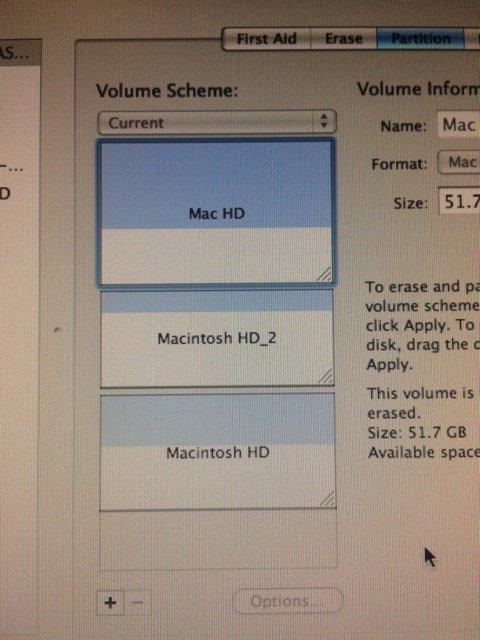

I made a big error. I was able to make a FAT partition, but the installer didn't see it. So I removed it. Now it just shows it as greyed out space in another partition, how can I reclaim this space? IMG_0981.JPG
I know how to remove partitions, it's just that when I removed it the space it took up was not returned to another partition. It wasn't able to be modified other than adding another partition in the empty space.
I fixed it by making a partition in the space, and shrinking it to 1GB, then removing it. Not sure if that's a bug, but it worked.

I made a big error. I was able to make a FAT partition, but the installer didn't see it. So I removed it. Now it just shows it as greyed out space in another partition, how can I reclaim this space?View attachment 872433
Can't you just increase the size of the 3rd partition claiming that space shown in grey color?
You may also try to start the iMac in TargetDiskMode and run DiskUtility from a FireWire-connected PPC/Leopard. I had one occasion, going that TDM/FW-way to get problems sorted out on an intel-Mac.
But before fiddling more with DiskUtility I'd go the way, @vertical smile mentioned: make some bootable clones of your existing Tiger and Leopard partitions onto one or better two separate external USB-drives, to have some fast available backup ( /w SuperDuper! or CarbonCopyCloner).
