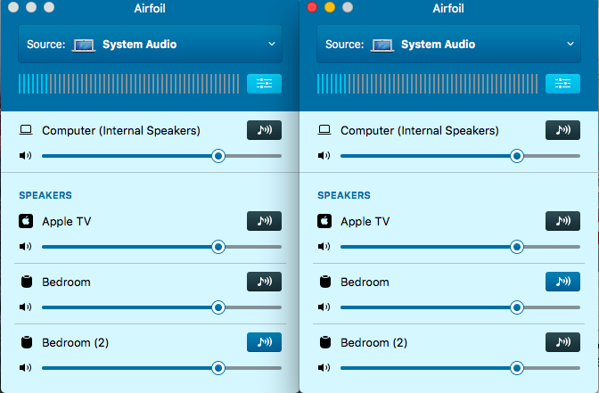

3. Open it and ensure that all of your AirPlay-enabled devices appear.
4. Choose your audio source. Easiest way is to choose System Audio. Then all sounds from the mac will play. But if you are a bit fussy about mouse clicks not coming through for example you can select specific apps instead which will exclude such noises.
5. Go to your Applications folder on macOS and find the AirFoil app. Right click on that file and choose “Duplicate.” This makes another copy of Airfoil called Airfoil copy.
6. Open Airfoil copy. It will open right over the Airfoil window. Move it away from it.

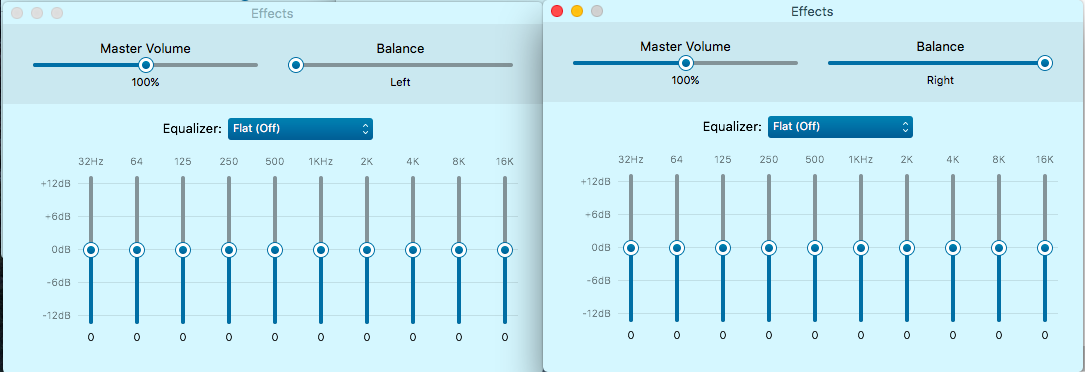

7. In AirFoil, choose the HomePod that’s on the right side of your configuration. Click the equalizer icon along the top and drag the “Balance” slider all the way to the right side. This will play only the right channel through that HomePod.
8. In AirFoil copy, choose the HomePod that’s on the left side of your configuration. Click the equalizer icon along the top and drag the “Balance” slider all the way to the left side. This will play only the left channel through that HomePod.
So here is my setup: (Bedroom is the right homepod and Bedroom (2) is the left homepod)
Main windows: (unfortunately the apps both call themselves Airfoil, not Airfoil and Airfoil copy so it can be a bit tricky to see which one is which - not hard though once you get used to it.)
Left and Right Balances:
