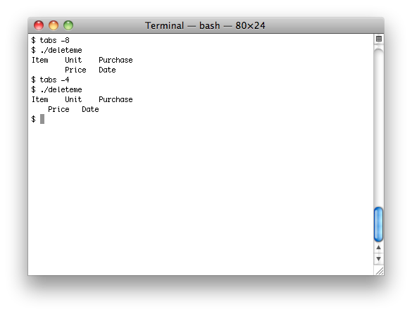

Better is relative. You still have no guarantees how the tab stops are set up if you switch anything. If I have tab stops set to 4 characters instead of 8 your code will no longer line up because Price is longer than 4 characters.
e.g. http://www.mackb.com/Uwe/Forum.aspx/mac/4700/Q-Tab-spacing-in-Terminal-app
EDIT:
If you're going to use tabs and distribute your code you need to make sure you control the tab stops. See attachment for example.
B

I just checked my editor, (textwrangler) and I'm using fixed width fonts (monaco) and my tab stops are set at 4.
That explains why your original experiment with literal tabs (^I not \t) didn't work. Terminal defaults to tab stops of 8.
