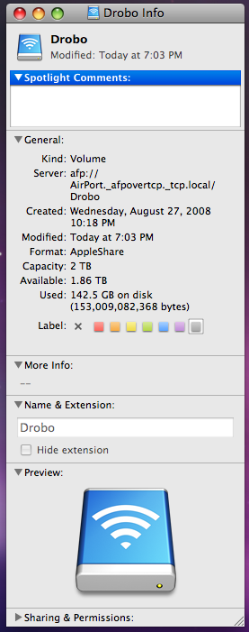

Hey all, I just picked up a new MBP which I love already. This is my first Mac and Im already converted. Im trying to talk my wife into getting an Air or something else. Anyway... I recently got an Airport Extreme and a Drobo about a month before I got my MBP. I formatted the Drobo with a PC using MacDisk and then plugged it into my AEBSn. It saw the Drobo right away, and prompted me for a disk password to access it. I provided the info which I configured in the Airport Utility. My PC then displays the drive mounted and accessible. I can read and write to the Drobo from my PCs no problem. So all is well.

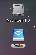

I get my MBP on Friday and start setting it up. Initial set up couldnt have been easier. So refreshing to not have to fight with my computer to get it to work.. So my MBP sees the Drobo but it is showing up as a Shared and not a device. I can read and write to the Drobo and I even put my iTunes Music folder on the Drobo and use that to feed my iTunes, working like a charm.
When I attempt to set up Time Machine, no such luck. It does not display my Drobo. Also, my Drobo isnt displayed when I go to Disk Utility I dont see the Drobo, which I think is ok because the Drobo isnt locally mounted.
So anyway, anyone have any ideas why I cant point Time Machine to my Drobo? I dont think the Drobo is the problem cause I can read and write to it without issue. Is there a way to mount my Drobo so its not a share but instead a device?

Well, I think its showing up shared cause its my AirDisk, right? I plugged it directly into the Mac and Time Machine found it right away. But when its on the AEBS it never sees it. Finder sees it as a shared and I cant figure out how to mount it as a regular device. So I figured I would try to format it just to be safe.

I tried formatting my Drobo last night using Drobo dashboard and it told me to use the Mac OSX Disk Utility. So I tried that too and it told me I didnt have permission to do this. I am the admin on my laptop so why wouldnt I be able to format the Drobo?
If you haven't solved your permission/formating problem yet, you might want to see what the read/write permissions are on the Drobo. You may have admin status on your laptop, but you formatted your Drobo via PC/MacDisk. Am I correct? ...and so, you may have assigned permissions (via you PC) that don't give you admin access on the Drobo.

Yep, I formatted it originally with the PC using MacDisk. I will try to plug the Drobo directly into the PC and load up Drobo Dash and see if there is any kind of permission properties I can change, good suggestion. Thanks Mad.
I did however, plug it directly into the Mac and Drobo Dash told me there was a firmware update and a Drobo Dash update, I loaded them both up, rebooted the Drobo, plugged it back into the AEBS, rebooted the AEBS and now I can see the Drobo in Time Machine, it backs up and can restore no problems.
