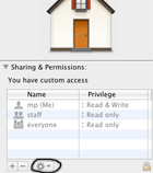

It can get confusing as some Home/Library files require other permissions. Never change root HD permissions unless you know exactly what you are doing. Did you by chance add your user account to the root HD as Owner or anything? Simple fix may be to just push down permissions from your Home directory. Then repair system prefs with Repair Permissions in Disk Utility. Log out and back in. If this is still jacked your going to have to fight inheritance between HD's or use a file server via afp, smb to clean the files and inherit to the account they are being copied into. If they were ACL based it would be much simpler but POSIX can be tough when they do not comply. Make it look like this.

I understand some of what you said. I need newbie English. But as I understand it, I should go to my home file
push down the circled arrow and hit apply to enclosed, repair permissions, restart and the image files will be fixed?

Custom access usually means you have an inherited ACL or foreign user permission on the files. Most likely your last account if you changed the name.
You want to change owner and clean permissions on the directory that is giving you the password dialog if it resides in your User folder then do it there (especially if this is the only directory you are having issues with). If it is on another disk it depends on the format and whether you have Ignore Permissions checked. One safe way would be to copy the folder from external to Home directory somewhere and then change owner and push down permissions and then copy back to external making sure the external is HFS+ and does not ignore permissions. The directory will then be an extension of your home account no password needed. Sometimes cleaning permissions can get frustrating and not all fixes work in all cases.
Just change all the extra non OS HDD's that have data you need to get to to owner: you, User: You, Staff: Read Only, everyone: Read Only.
Add your self then go to the Action cog and make owner then press the action cog again and push down. Do this for each offending directory.
AAhhh thank you. I went to the offending drive which has the pics (internal, but not startup), changed the ownership from unknown to me. I was afraid to press apply to enclosed folders (as I got into trouble with that earlier)but when I went to a jpg that had an unknown owner, I made a change, saved, and now the ownership changed to me. Don't know why it worked, but it did!
