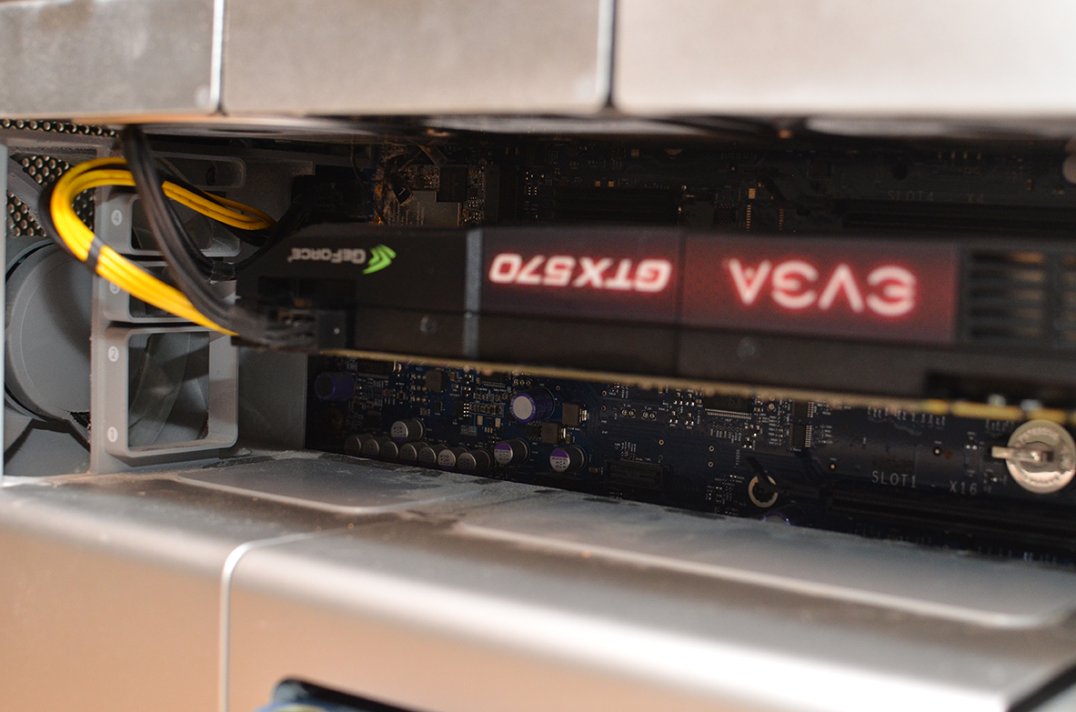

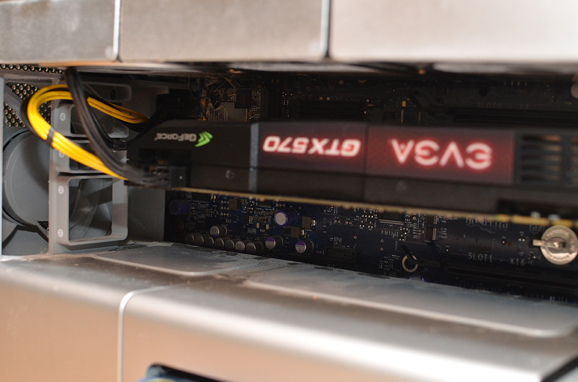

I'm not sure if this is even helpful. You can't really see the fan now that it's in slot 2. On a side note, it has been working flawlessly in slot 2 since I placed it there. But it also worked in slot 1 for a week before having issues.
