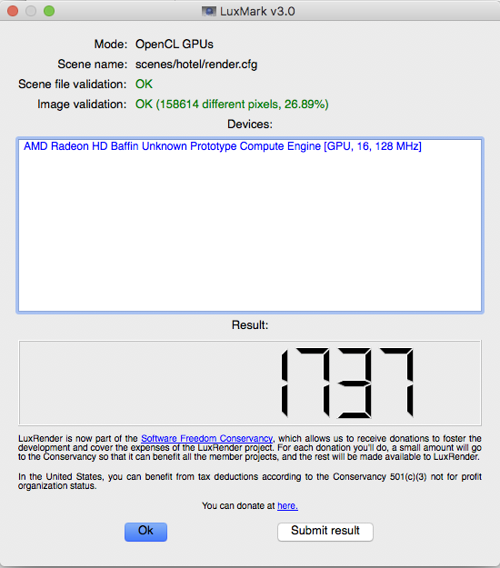

I just benchmarked RX480 with LuxMark and I got this score: 1737. I think something is wrong. A thread starter got 11455 from LuxMarker.
[doublepost=1478463482][/doublepost]Base on LuxMarks, I got
Hotel: 1756
Neumann: 6257
Luxball: 11056
Is it a problem or wait for another updates?

You're running your GPU on hacked beta drivers meant for a different GPU, you can't expect a lot from that. Additionally, OS X APIs/drivers have a quite high CPU overhead, so you might be limited there.
But that doesn't explain why am I getting low benchmark score compare to other RX 480 owners.
11455 vs 11056, nothing wrong here.
p.s. You can't compare Hotel score to the Luxball score.

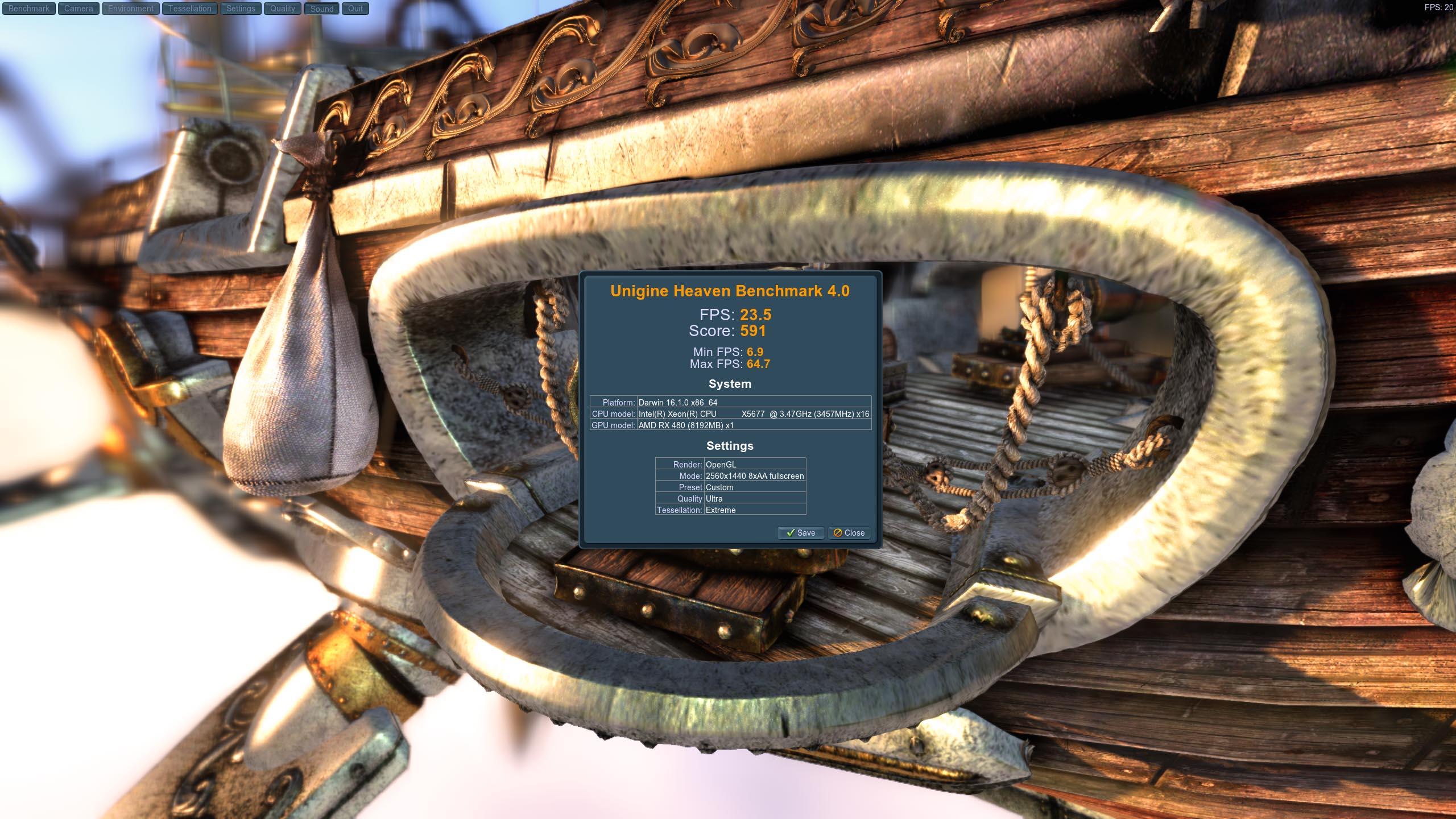

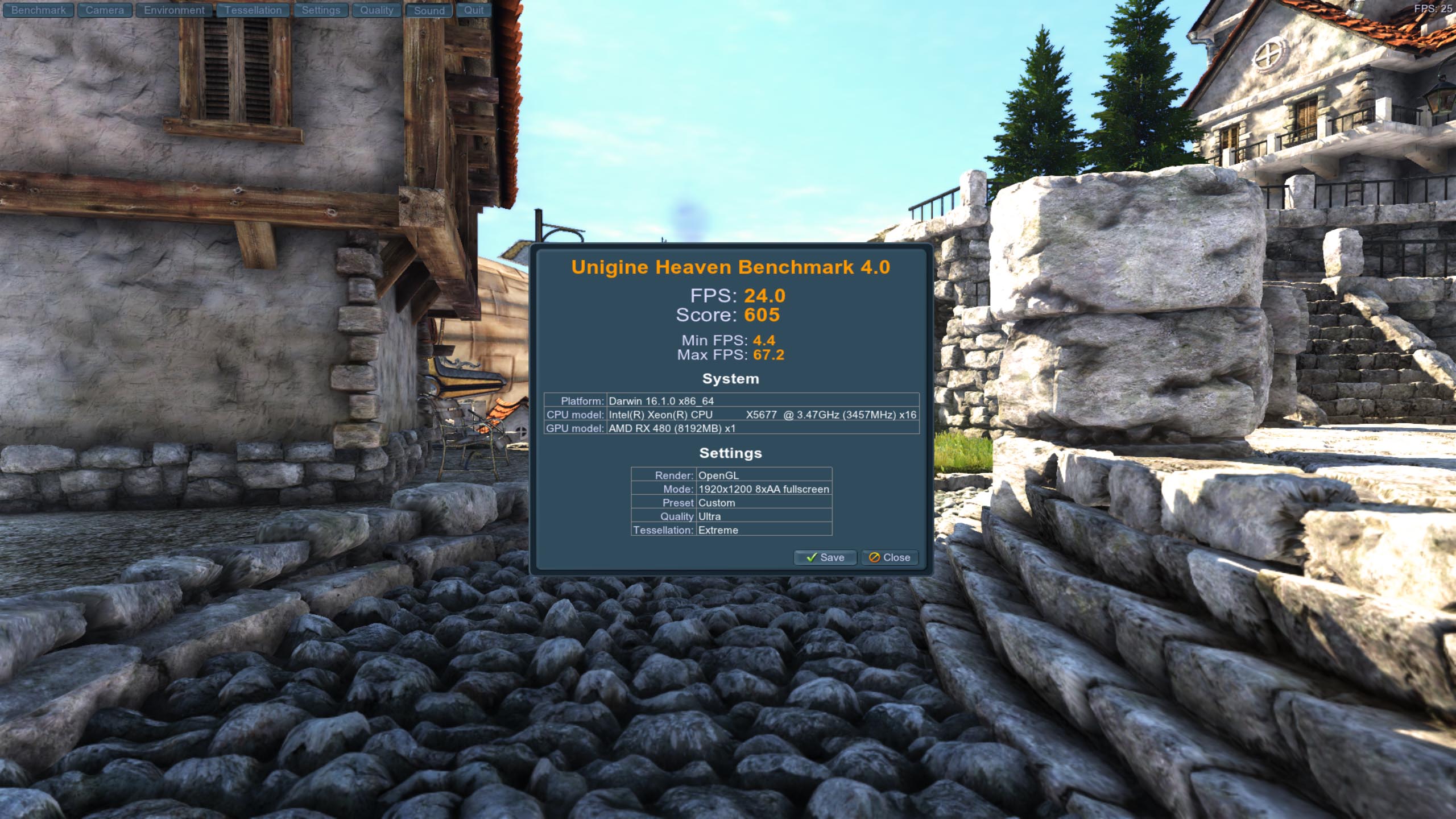

It should've be around 40 FPS but it's not.
I can't 100% rule out that your GPU is not performing as good as the others in OpenGL (OpenCL is definitely fine by comparing the Luxmark score). However, 2560x1440 is NOT comparable to the 1920x1080 result.
Your score may be normal because you were NOT using the standard preset. You can make it run at 8K resolution and have extreme low score if you wish.
In order to make it comparable, please choose one of the standard preset and do not alter anything.
ps SC2 is massively CPU dependent, even on windows people complain about this.
do not use SC2 as a benchmark
Can you repeat the benchmark with Heaven / Extreme preset or Valley / Extreme HD preset? That's what most people use.
