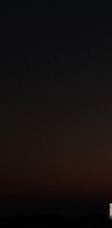

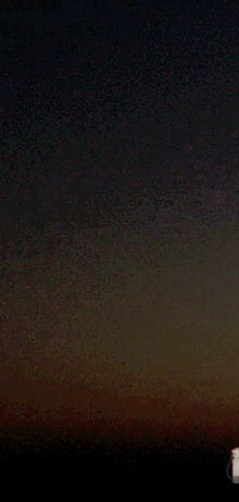

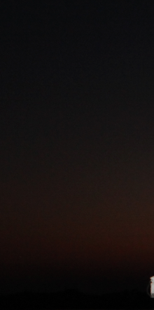

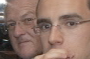

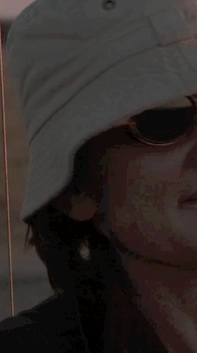

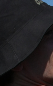

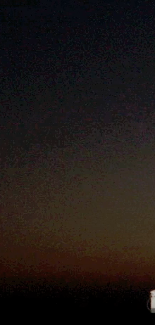

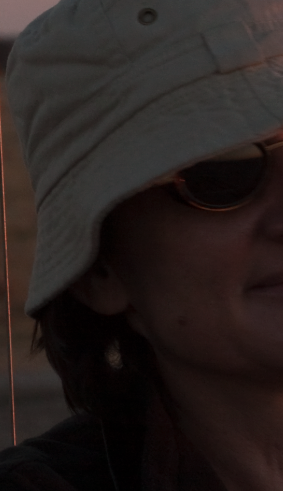

The images aren't being scaled down, I have every option I can find set to the highest possible quality, so really can't find what's going wrong. Here's a quick sample of some cropped areas to highlight what I mean. 2 are from Aperture, 2 are the same photos (I exported the master files to the desktop and then imported those masters to iMovie).
iMovie
iMovie

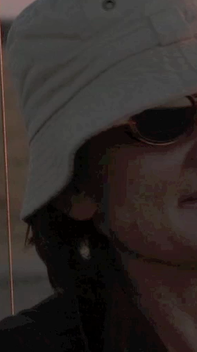

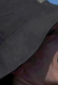

Here are four more. first two are iMovie / Aperture again, the next 2 are final cut express / aperture, where the quality is better but the colors are all off.
iMovie
FCE
It looks to me like it's a gamma setting problem in FCE. I know that in FCP I can set the gamma of each clip.
The FCE photos looks like a gamma problem that could be solved with some color correction. The iMovie photos look like 8bit banding that could be solved in an NLE that supported 10 bit rendering.
Trying to use the color correction filter and the gamma filter is getting me somewhere, but it's getting very difficult to get the colors correct and I'm thinking it's going to be a nightmare to do this for several hundred pictures.

Unfortunately, it does not matter what the source is that you put into iMovie, what you get is 8 bit banding (lower quality) on output no matter what. This is because footage is transcoded using the Apple Intermediate Codec on import, which is limited to 8 bit color on output. 10 bit color is not available. If you were to use a full featured NLE (non-linear editor), such as Premiere Pro or Final Cut Pro, you wouldn't have banding problems using ProRes or other advanced codecs, using 10bit color.
