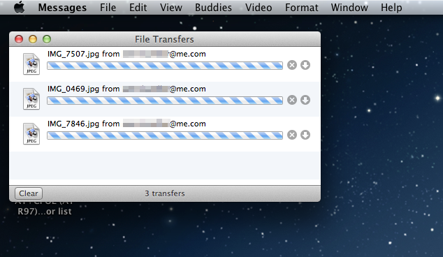

Transfers stays forever in "waiting" state. I cannot send files via Messages on Mac and I cannot receive files on Mac.
Here is a detailed error message:
17.07.12 17:58:39,887 com.apple.imfoundation.IMRemoteURLConnectionAgent[12343]: [Warning] Denying xpc connection, task does not have entitlement: com.apple.private.imcore.imremoteurlconnection (IMTransferAgent:1607)
17.07.12 17:58:39,888 com.apple.imfoundation.IMRemoteURLConnectionAgent[12343]: [Warning] Denying xpc connection, task does not have entitlement: com.apple.private.imcore.imremoteurlconnection (IMTransferAgent:1607)
17.07.12 17:58:39,889 com.apple.imtransferservices.IMTransferAgent[1607]: [Warning] Remote loader crashed for request: <NSMutableURLRequest http://init-p01md.apple.com/bag>
17.07.12 17:58:39,889 com.apple.imtransferservices.IMTransferAgent[1607]: [Warning] Bag loading failed! Error (__kIMRemoteURLConnectionErrorDomain:-1): Der Vorgang konnte nicht abgeschlossen werden. (__kIMRemoteURLConnectionErrorDomain-Fehler -1.) (null)
17.07.12 17:58:39,892 com.apple.imfoundation.IMRemoteURLConnectionAgent[12343]: [Warning] Denying xpc connection, task does not have entitlement: com.apple.private.imcore.imremoteurlconnection (IMTransferAgent:1607)
17.07.12 17:58:39,899 com.apple.imtransferservices.IMTransferAgent[1607]: [Warning] Remote loader crashed for request: <NSMutableURLRequest http://init.ess.apple.com/WebObjects/VCInit.woa/wa/getBag?ix=1>
17.07.12 17:58:39,899 com.apple.imtransferservices.IMTransferAgent[1607]: [Warning] Bag loading failed! Error (__kIMRemoteURLConnectionErrorDomain:-1): Der Vorgang konnte nicht abgeschlossen werden. (__kIMRemoteURLConnectionErrorDomain-Fehler -1.) (null)
17.07.12 17:58:39,900 com.apple.imfoundation.IMRemoteURLConnectionAgent[12343]: [Warning] Denying xpc connection, task does not have entitlement: com.apple.private.imcore.imremoteurlconnection (IMTransferAgent:1607)
I hope file transfer is possible in the final release of Mountain Lion.
By the way: Logging off and re-login my iCloud Account doesn't help.
