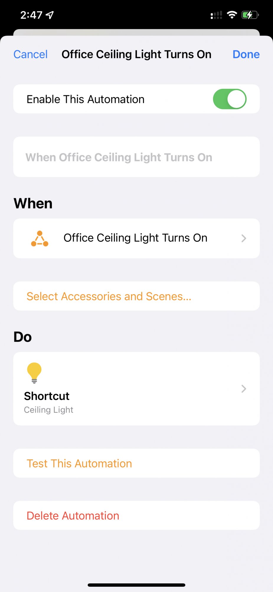

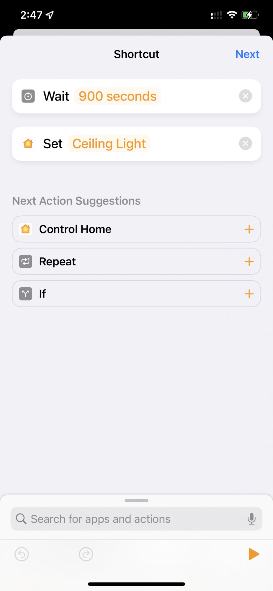

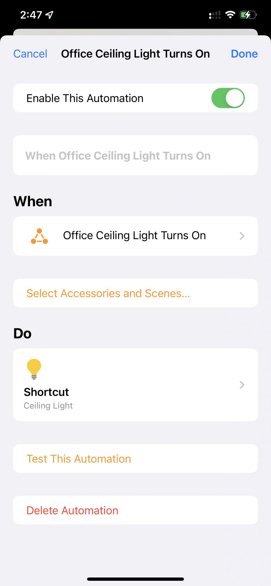

I read this a few times and I apologize if I'm missing something because it sounds like you just need a function thats been available for years, I might be wrong though. From what I'm reading it sounds like you just want an accessory to turn off 15 minutes after its turned on? If so that is a very simple shortcut that can be done a few ways.
Made this up real quick though using ShortCuts app...
WHEN 'Office Ceiling Light Turns on' > DO Shortcut > 'Wait 900 seconds (15 min)' > Set Ceiling Light - off
Now when the Office Ceiling Light is turned on it will turn itself off in 15 minutes. That is about as simple as ShortCuts get.
View attachment 1904942View attachment 1904943

Yes, I agree it should be that simple (and it is in the GUI).
But have you tried that shortcut? It doesn’t work :-(
The trick is that no shortcut task is allowed to run more than a maximum of 10 minutes. After that it’s just killed by the OS, and everything after the ”wait” is never executed. The 10 minutes is the limit on Apple TV as a hub. I you use an iPad it’s shorter (depending on battery state), but it’s between 3 - 10 minutes.

Could you step us through this? I do not see on what UX tree an item turned on can be found. Is it Personal Automation, but I do not see a path to a switch changing. Home Automation looks like a dead-end.
