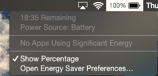

I have a mid-13 13" i7/8GB/512GB MBA and have no problems hitting at least 10, if not the whole advertised 12hr life on my computer when I'm doing actual school/productivity tasks focused on schoolwork.
It's when I start watching youtube videos and streaming music and using FaceTime where the battery starts to get drained fast.
ETA: I would never have called the MBA battery life piss-poor. Maybe in three years but that's a result of batteries being a consumable item.
Mid '13 13" i5
