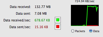

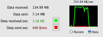

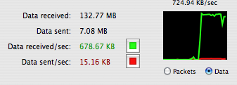

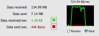

The audio thing didn't work-
but here's a screengrab of activity monitor- the first while loading a trailer on Apple.com (quicktime I assume)
The second while loading a flash video from CBS.com
I'm at their house now if anybody has any other ideas!
