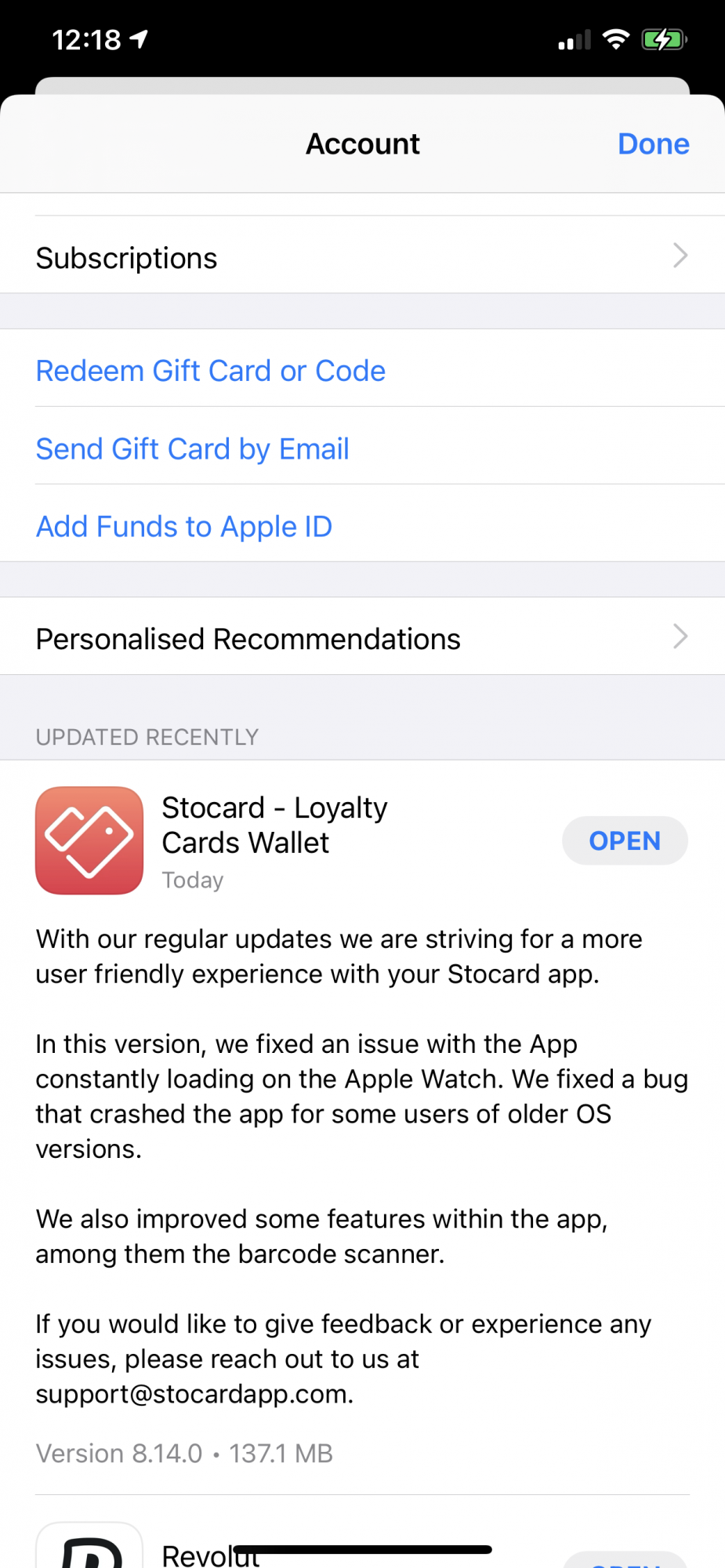

For anybody else getting the "Loading" message on Apple Watch (like me), this occurs when you haven't registered your account (under Settings > Account it will show registered). After I registered I needed to kill the Stocard app on the iPhone and Watch before it realised it was registered. Then the watch app worked as expected.

Yes I got pretty much the same reply from their support team this morning:
'Unfortunately, we're currently experiencing a bug that prevents the proper communication between the Stocard phone app and the Apple Watch. I can assure you that our developers are already aware of the problem though and are currently trying to solve it with an update as soon as possible. There should be a new update within the next few days which will make the Watch app usable again.'
