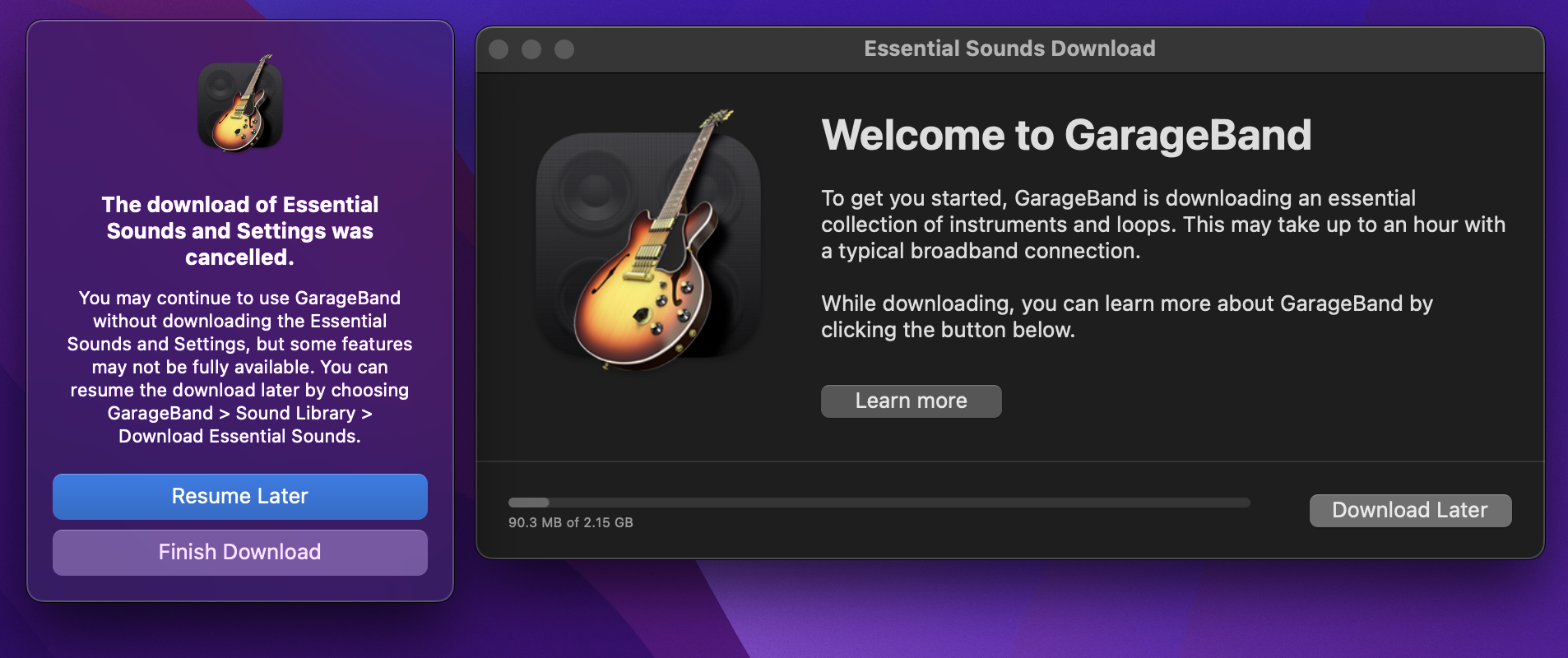

The other day I deleted a bunch of extraneous files that I do not need, including the so-called GarageBand "Essential Sounds" (about 2GB). But, unfortunately, I discovered another facepalm Apple developer decision/oversight just now when I went to use GarageBand to edit an existing audio track. Upon launching, without asking, it starts to download the Essential Sounds again and there is no option to "do not download" - you can only pause it and it will pick up again the next time you launch GarageBand. This is absolutely asinine. Is there a terminal command that will stop GarageBand from checking if the Essential Sounds library is there? I simply can't believe this is not a UI preferences option.

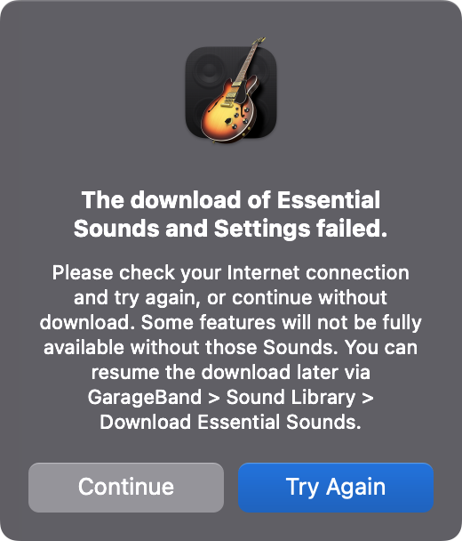

Yeah it's a goof up. What dialog comes up if you're disconnected from the internet (or blocking the attempt using something like Little Snitch or Lulu)?
If no internet:
But of course I shouldn't have to shut down my Internet to launch GarageBand without it trying to download files, especially since I'm often streaming something or downloading something in other apps at the time.

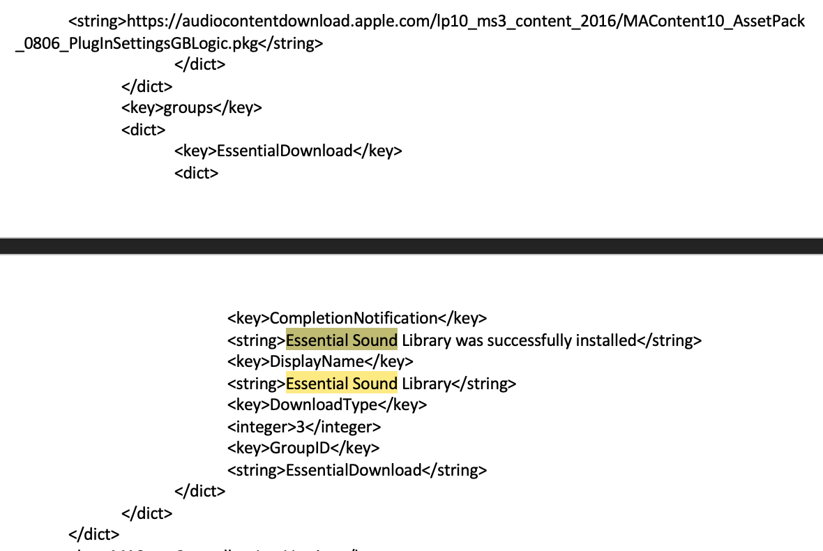

QuickLook lets me view the file's contents, but I'm not sure what app to use to open and edit a .plist file, nor what I would even edit to resolve the issue I'm having. Pasted into a Word document with half-inch margins, it's 300 pages long! Attached
Here's the only section that has the phrase "Essential Sounds" in it:
