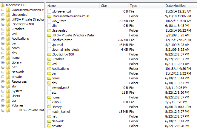

Update
So I was able to use a program called HFSexplorer in the Windows bootcamp partition to view the Mac OS X file system. I'm able to extract files from the Mac partition into the Windows partition.
So the hard drive definitely works right? I'm not very familiar with how the boot system works, but could it be that some files are corrupted? Anyone have any information.
HFSexplorer:
