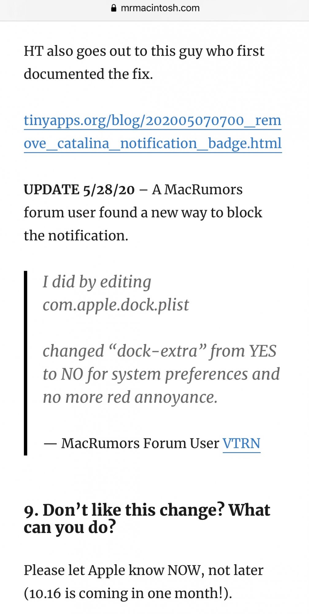

and this (screenshot from the link attached as well as the article is quite long): https://mrmacintosh.com/10-15-5-2020-003-updates-changes-to-softwareupdate-ignore/
I tried the first method (Close the Settings app if you try it):
defaults delete com.apple.preferences.softwareupdate LatestMajorOSSeenByUserBundleIdentifier && softwareupdate --list
....and it helps so as far as I specifically go to update settings again. And I personally also unticked all the boxes under updates / advanced.
Screenshot regarding the second method:

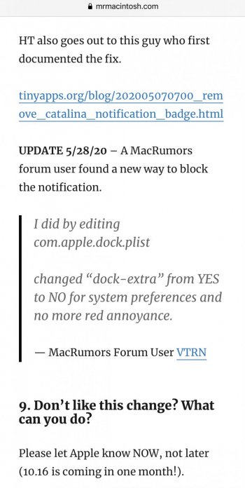

See this page: https://tinyapps.org/blog/202005070700_remove_catalina_notification_badge.html
