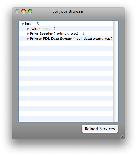

That's what I'd expect to use (and do use) but i still run into the problem. Here is a screenshot of the Bonjour Browser I'm using to search for services - you can see that the witap service is available even though the app is no longer running on the device. When I run the app in the simulator it behaves correctly.
