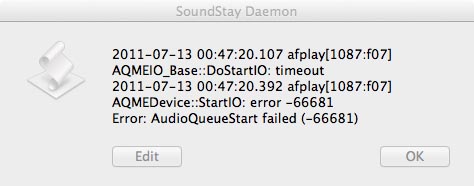

Not such good news now, I'm getting crashes from your little app.
See attached file.
Any ideas?

Try this one out. This version is completely self contained so no need for an uninstaller. Just remember to uninstall the old version using the previous installer first.

Just thought I'd let you know that SoundStay works well when it's loaded, but unfortunately, it is crashing a lot with the 'SoundStay has encountered an error' box.
Any thoughts?
Hmm, I don't know what the problem is, I am yet to experience a crash myself. Maybe there's is a conflict with another app you're using? 😕 I'll see what I can do.

OK, I've identified one situation where SoundStay crashes each time, and that is when playing a movie in iTunes that is passing DD5.1 through. Within about a second, the dreaded message comes up every time!
Great, thanks a lot for your help with this.
Try these 2 out, fingers crossed.
Thanks for your time.
No luck, I'm afraid. The first one just crashes when iTunes plays a DD movie with the error box.
The second one doesn't produce an error, but just unloads when iTunes plays the movie.
