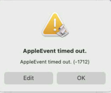

I have several events that get triggered by an Application called “Scheduler”. However sometimes I get massages that they time out. Below is one that times out on me. It is saved as an application. And in the Security Panel all preferences are set properly as it runs fine if I manually trigger it.
The first bit checks if we have a network, I added the spoken text etc. to hear if it is working since it is a server that runs the application. (Mac Mini OS 11.6.1)

anybody has an idea as to how to fix this? Or what could be wrong?

This error can happen when an event takes an unusually long time to complete. If an event takes longer than two minutes, the Apple Event Manager reports a time-out error. To prolong the amount of time AppleScript waits for a response: Use the "with timeout" statement. Info: AppleScript Language Guide
This has a lot of similarities with your Calendar.app not running Apple Script Applications at time (OS11) post. Different error but the code looks similar. Added bonus is an application called “Scheduler”. Did you make this "Scheduler" application? My suggestion is to include log entries in the script/app to find the error that's causing the AppleEvent timed out error. That advice was also given here. What's up with al the delay statements?
Ok I did wrap it in a timeout (3600) and this does nothing. so somewhere it still bugs-out on me. Any suggestions anybody?
The script has been tweaked to include error messages to the log and looks like this now.

the first one is a working one the next one is a hung one with the box popping up "AppleEvent timed out".
Any ideas as too how to proceed? It seems to hang before Mail gets called.
Could it be a security setting somewhere?
