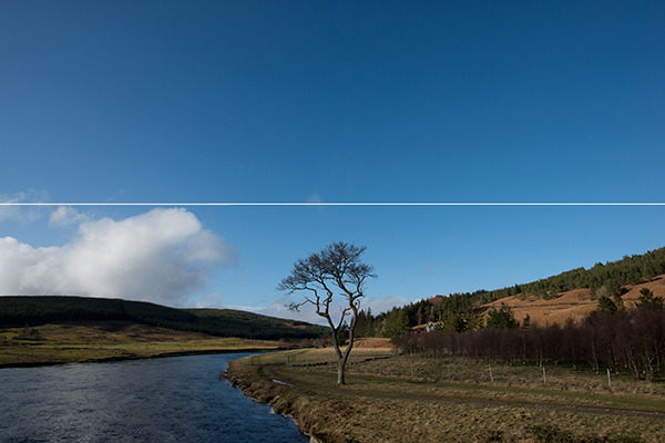

Something in the T3 started to go wrong about two months ago (deduced from dates of images affected etc.). Images on the T3 began to open like this in Preview
You can see the line, obviously. On seeing this the first time (not this image) as it was not part of my C1 library I assumed that it was a one off - no other image in that file being affected AND no bad images appearing in C1 itself. Not all my stuff is in C1..

OK. Update.
Three visually different forms of corruption present in my Libraries.
1/ white line - cured (hopefully) with the help of PhaseOne. Action taken - turned off CL, updated D800 firmware and create previews from RAW during import so that in future RAW image errors will show in previews (not using camera jpg).
2/ half (approx) of image affected is blacked out - no reason for this found yet.
3/ stripe made of zigzag colours on affected images - no reason found yet.
It looks like whatever caused 2&3 is beyond most people I have contacted so unless I can get a definitive action/reaction that is obvious in the future I will just have to live with some duff images in the library.
