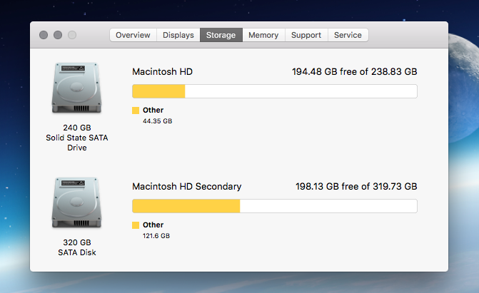

So today, after some months I decided to check my storage via, About This Mac > Storage
I was surprised to see that both my drives were only displaying 'Other', please see attached screen print, when in actual fact, I know my set up is as follows:
Main drive (OWC SSD) 240gb > Applications only
Secondary HHD (Original HHD shipped with MBP) - Photos, Videos, Documents etc
So I was expecting the displays to show the above information correctly.
Unfortunately, I have no idea what may have caused this and having searched the World Wide Web, I am unable to find the solution, to my issue(s).
I would be eternally grateful if someone can point me into the right direction to how I can resolve my issue(s).
Any help will be more than appreciated. I own an early 2011 MBP.

Looks like the volumes are excluded in Spotlight preferences, which means it can't index and so just calls everything "Other".
Go to System Preferences -> Spotlight -> Privacy-tab. Remove the volumes there.

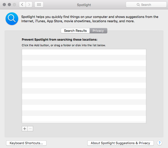

Cheers JTToft, but no luck. I navigated to where you suggested but it is totally blank.
I am attaching a screen print.

Nope, no luck with that solution either, me think its time to do a clean install.
Thanks for your help
[doublepost=1472256795][/doublepost]JTToft, solved it. Apparently my Spotlight server was disabled. once I had re-enabled it voila, its showing the correct volumes.
