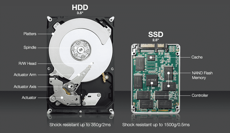

SSD drive is perfectly fine for storage, and is more likely not to fail versus a HDD.
The issue you probably heard about is that SSD failures are much harder to predict, and once it has failed, it is usually gone forever.
HDDs have a higher chance to failure due to the moving parts, but is often predictable when it might fail. A HDD can show signs of failure for a long time before they fully fail, sometimes even over a year.
During that time you can attempt to back up all your files and have another storage solution in the works.
For SSDs, there is usually no warning, they just go dark.

In difficult environments (dust, heat, vibration) SSD's clearly have a reliability advantage. But in a controlled environment that is no longer true. SSD's will wear out:
SSDs: 30-80% test developed bad block in their lifetime
Hard Disk: 3.5% developed bad sectors comparatively
(There are conflicting reports).
It also depends on the SSD type, QLC or TLC. A Samsung TLD 860 EVO has a 5 year warranty or 600 Terabytes Written (TBW). Their 860 QLC has just a 3 year warranty or 360 TBW.
In contrast a Seagate Exos X16 hard disk has a 5 year warranty for 550 TB/year or 2750 TBW, more than 4 times that of the 860 EVO, almost 8 times greater than the 860 QLC.
