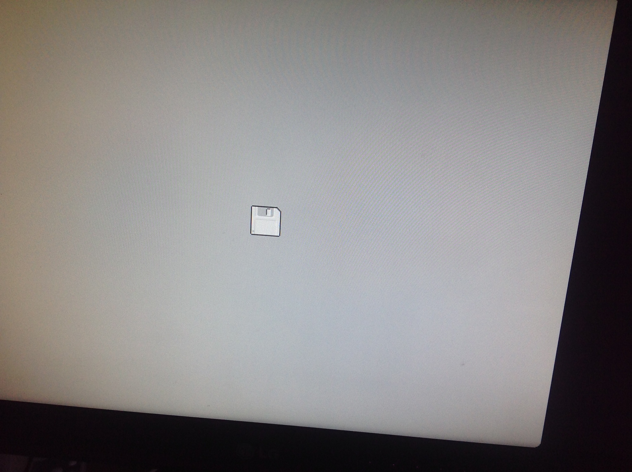

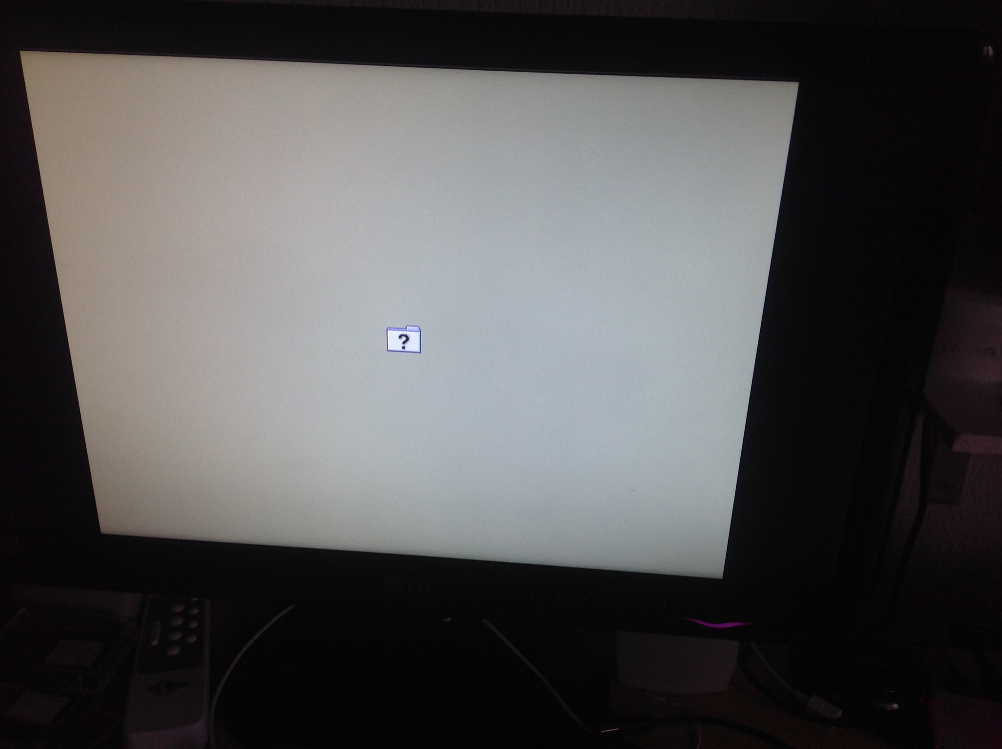

Upon reboot, the machine showed a greyscale screen with a floppy with a blinking question mark inside it (like those 80s / 90s macs show when no floppy disk is inserted).
I tried to boot using the Option key but since the OSes are installed on the same partition this was of no use - It listed my HDD and that was it.

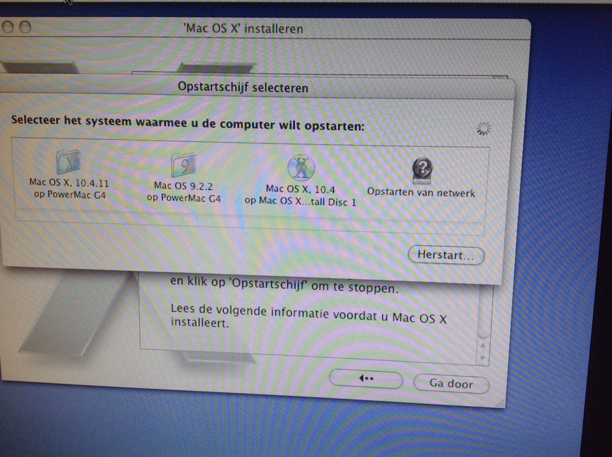

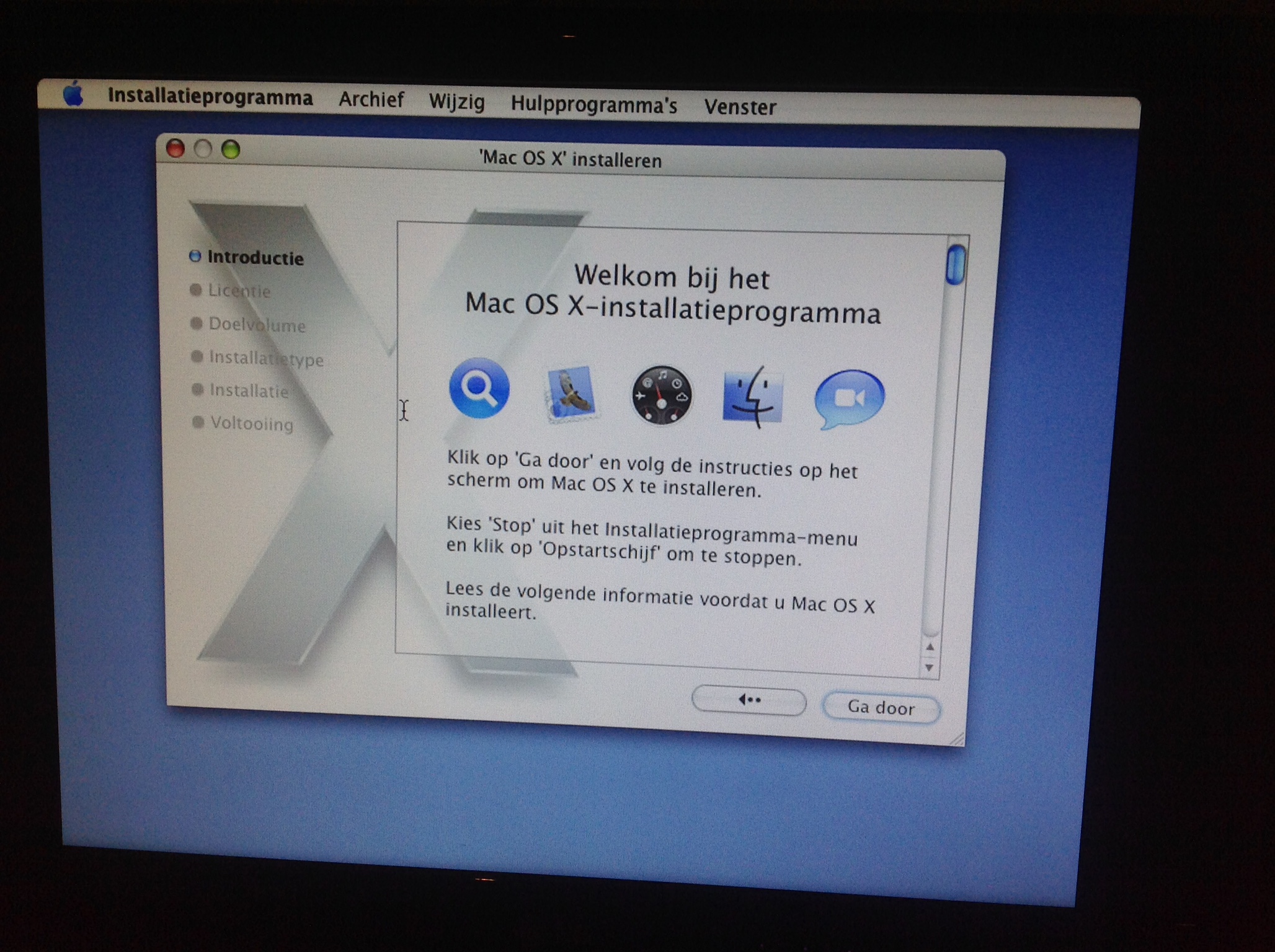

Then I inserted the CD with 10.4, waited and waited and: it booted!

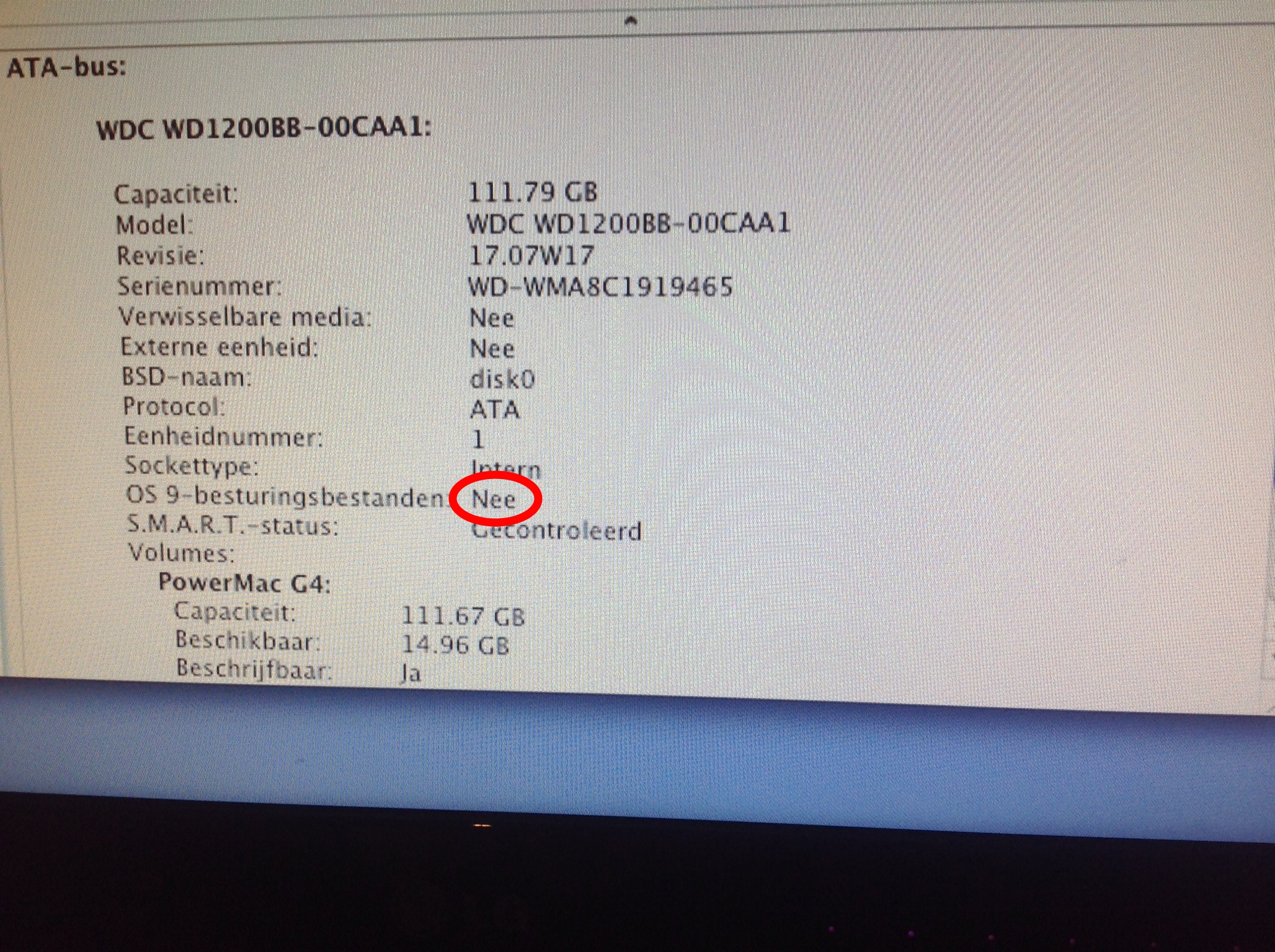

I chose Apple System Profiler and there it said it: Mac OS 9 drivers installed: NO
Knowing for 100% sure what the issue was, i clicked on Startup Disk and selected my 10.4.11 installation.
I crossed my fingers, rebooted and my machine was back to life again 🙂 🙂 🙂
