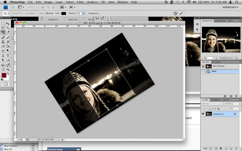

Ok, can someone please help me with this? It drives me nuts. I have an occasional crooked photo and want to straighten it. I rotate it until it looks good, which of course means it needs to be cropped to look straight. But when I try to crop, the crop is straight in reference to the photo (as in, it just follows the photo's angled side) so it's useless. I click on the side so I can angle the cropping frame, but often this does not create a perfectly straight line and leaves a little bit of a jagged edge. Is there a way to just make the cropping field straight, regardless of how turned the photo is? Thank you for any help, this annoys the hell out of me.

Do you mean Free Transform? I'm using CS3. How does rotating the canvas and cropping differ from rotating the Crop frame? You're still stuck with that pixel to pixel jump that gives not just what I want results.

I Think what the OP is reffering to is that when he turns the pictures to straighten it, the Crop selection also moves... when you use a Multi Touch trackpad to turn the Picture, you are not not turning the picture itself but just the view.. its weird to explain 🙄
I think that is his problem, you can see ho the crop box turns as well as the Picture itsef
