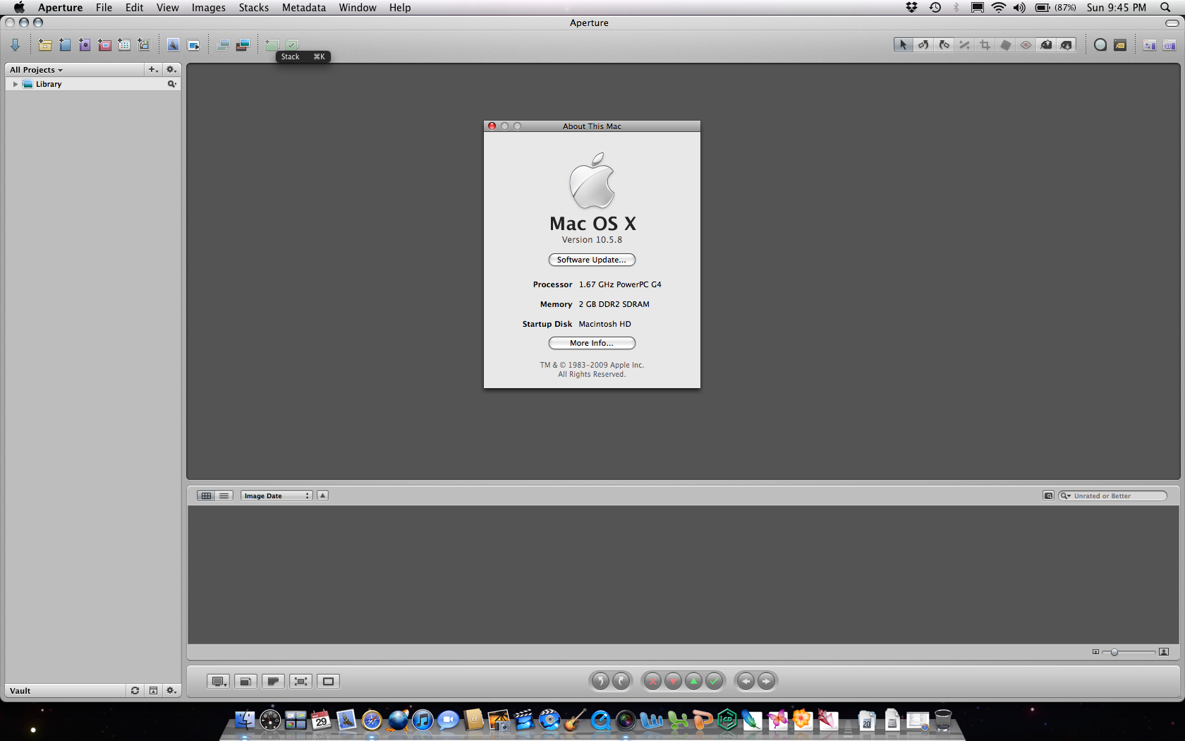

Once I had the computer booted with a core image card, Aperture installed without a hitch. As I mentioned-the dual 1.8 Gigadesigns(currently running at 1.6ghz) uses 7447As. The 1.25ghz+ Powerbooks that are supported use 7447As(in fact, the processors on my upgrade card were factory rated for 1.25ghz). All I can guess is that Aperture uses some instruction set in the 7447A that's not supported in other 7400/7450 series processors. I'm talking out of my rear end on this one, but it's the only thing I can think of. As I said, the program absolutely refused to run on my dual 1ghz QS, even though it has a core image card.

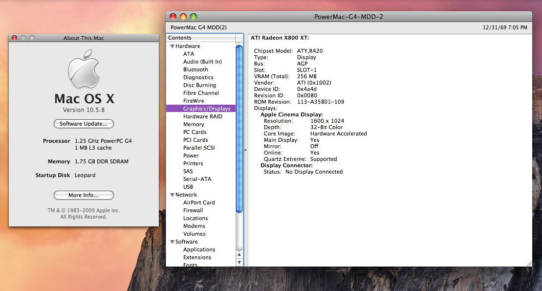

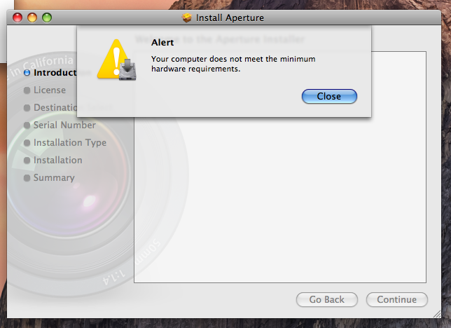

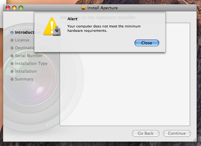

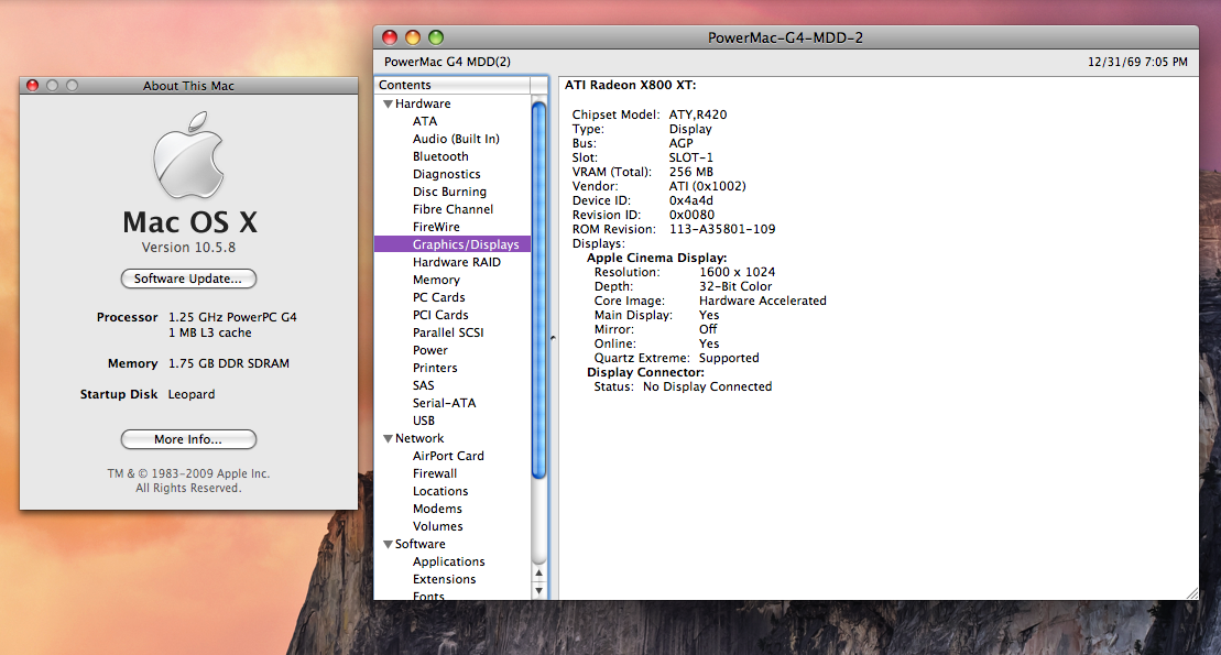

I think I can probably pretty safely conclude that Aperture requires a 7447A, and the install block is not simply a clock frequency check. I(finally) got the FireGl X3(X800XT) working in a 1.25ghz MDD, and Aperture refused to install.

According to the Apple system requirements here, they are very specific in terms of GPUs supported by Aperture. I wonder if the fact that your X800 is a flashed GPU is causing any issues. OS X may see and view it as an X800, but if the device identifier doesn't line up to the white list in the system requirements, it may fail anyway. That is just an idea that I have no way of testing.
When I tried to install it in my upgraded Quicksilver with a Radeon 9000, the error message was "Your video card is not supported." If the video card were the issue on the MDD, from past experience, I would guess that it would say that specifically rather than a generic "system not supported" message.
I can stick a real 9600 in it and try, though.
However, it could display the generic error based off the fact that it reports as an X800 XT. Try throwing a true 9600 class card in there and let it roll. Like I said, it is just an idea but it wouldn't surprise me if this is causing the issues.
