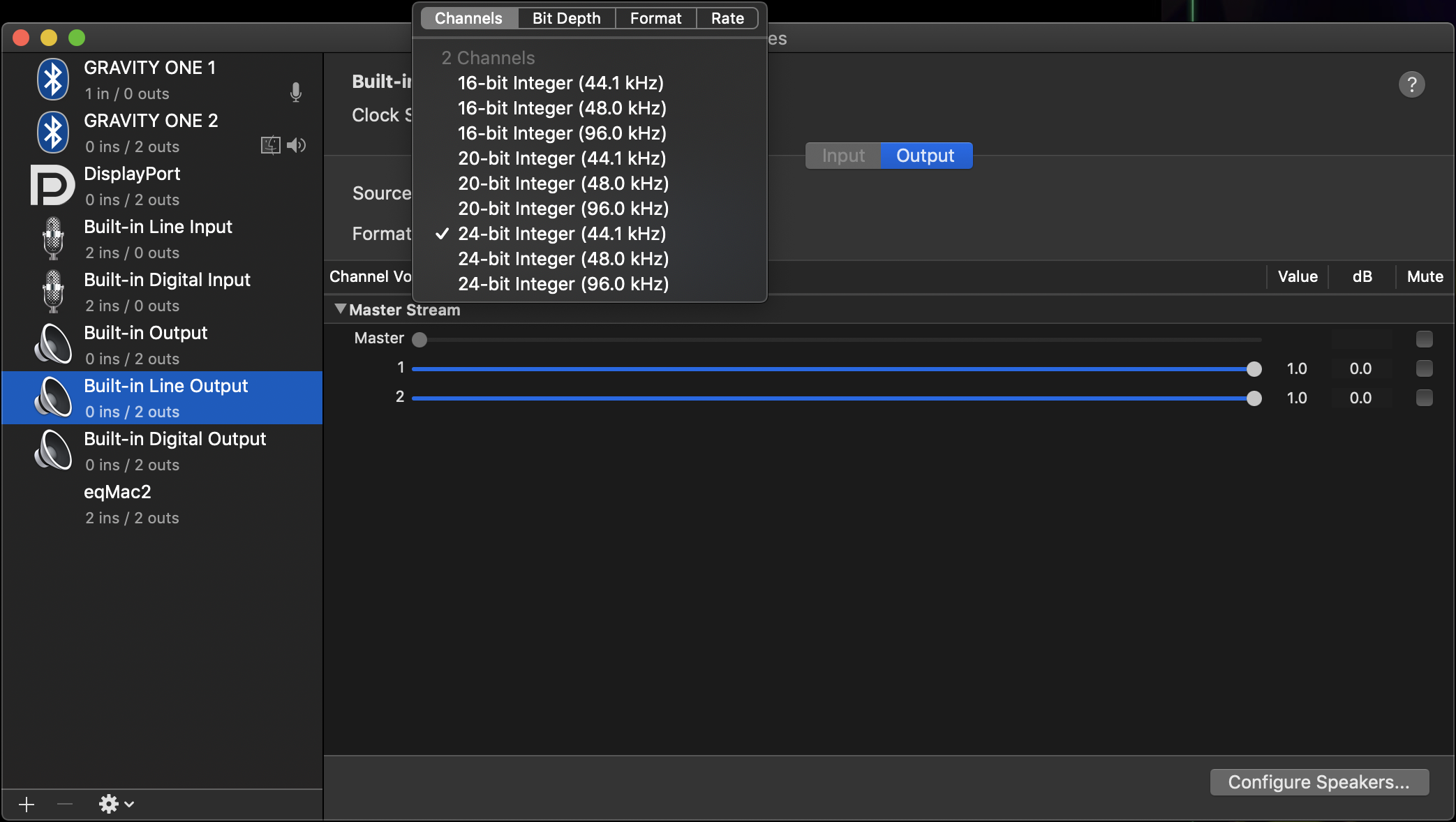

Heres the strange thing: I get audio playback stuttering when playing anything...no weird errors, runaway processes, etc. Also Im using the standard 3.5 lineout NOT HDMI or DP, but when using either of those its the same story (except HDMI which has no sound as expected) Completely Stumped...
To test, I installed a second drive with a fresh Mojave install...same issue...for the time it was on HS till my card came in (about a week) no audio issues to speak of. Any ideas? The only thing I can think of is it may be CPU/RAM related as those chips are older and its only got 24GBs of RAM...will be putting 96 in tomorrow though so I can see if that helps, but either way the RAM and CPU aren't being pushed that hard on AM when its happening so I don't think that's related...Thanks in advance for any advice
