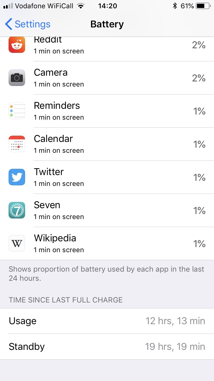

Hi all, I have a strange problem with my iPhone 7.
For the last few charges, I have abnormally high usage statistics which I’m sure you’ll all agree are inaccurate.
I suffered some heavy battery drain the other day so I drained the battery and recalibrated and that seems to have done the trick other than the high usage information.
The phone is 13 months old with 95% battery health. I have background app refresh off and do not overcharge the phone. As you can see, there doesn’t appear to be a rouge app that is causing the issue.
Does anyone have any thoughts? I have a Genius appointment booked for tomorrow and will request they replace the battery.

The battery should be fine if it has 95% health. Most likely it's a bug with iOS 11.3.1, there are lots of discussions here an on reddit about it. Try updating to 11.4 beta, it helped for some users with the same issue.
Also, you can try reinstalling iOS and setting up your device as new (make an encrypted backup first!). If the issue won't come back no need to replce the battery as it was iOS and not hardware.
p.s. Don't restore the backup before you will make sure that the issue dissapeared/still there.

Is the screen shots the ONLY apps in use? Are we not seeing any other apps in use (ie. Podcasts, Music, games, etc)? In one shot, Reddit is on top, yet on the other, Messages is above that. So, without knowing what other apps might be in use, hard to tell. For example, people report that the Facebook app is a huge battery user.
That said, not seeing anything to complain about. Yes, maybe a bug in reporting the usage number, but the standby number is pretty impressive (21hrs since last charge and only half the battery used).
Apple might not replace the battery, depending if the phone is still under warranty as the cheap replacement program is for out-of-warranty devices. And if under warranty, needs to be at 80% life.

Thank you all for the suggestions.
I have force restarted the phone and the high usage stats remain the same. Network settings have also been reset.
There is no apps running in the background such as Apple Music or Spotify that would cause the usage to go up so high.
A good suggestion on the Reddit app though. The drain started a few days after I installed it. Would it cause drain even though background app refresh is off?
I’ve uninstalled it for now to see if that is the culprit.
Apple have stated that the battery is in good health and only 206 charging cycles. The employee even commented on how good the condition of the phone was.
I’ll keep you all posted and thank you for the suggestions.
I had Battery drain from the App with background refesh off. It was just in my Memory/Ram after using it. And a soon as i closed the App, it stopped the drain. I think its a unknown bug that was introduced like 4 weeks ago with an Update to the Reddit App. Im using Apollo since and the problem is gone.
I’ve since moved over to Apollo and monitoring the battery.
