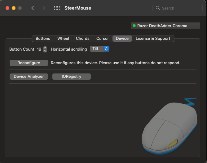

I've been using SteerMouse since High Sierra because Razer Synapse 2.0 stopped working back then. MacOS is not supported in Synapse 3. https://mysupport.razer.com/app/ans...~/mac-os-support-in-synapse-2.0-and-synapse-3

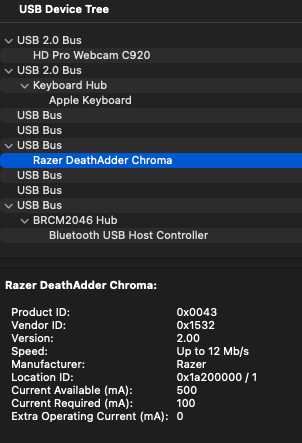

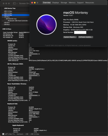

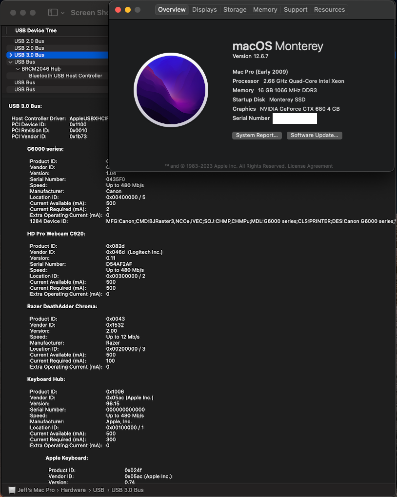

OK, installed the Sonnet Allegro USB 3.2 and the printer issue cleared. Can't reproduce the mouse issue as of yet either. I noticed when booting the mouse LEDs stay off until late in the boot sequence which is normal. When plugged into 2.0 ports they come on early in boot sequence then go out when booted to desktop.
Oh and this confirms Sonnet's claims that the Allegro USB card is plug & play in Monterey 12.6.7 and no issues with OCLP.
Now I just need some USB 3.0 peripherals.
