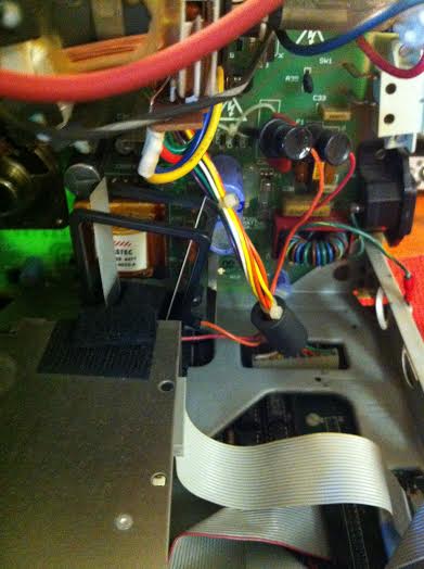

Hello Hunter

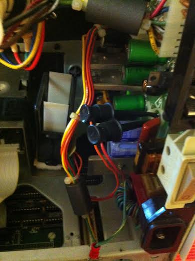

Speaking of not normal... Do you know what this is???

Hello Hunter
My first thought was an AC mains voltage fan. But looking at the shape of the device, I can't be certain - it looks very odd.
It seems to be held to the chassis with double sided tape. You'd need to take careful note of which diodes the clips are attached to before removing it.
I'm really intrigued. 😱 I've seen secondary power supplies for hard drives added this way, but that box looks too small to be a power supply.
It may be half of something that was mounted on the top of the floppy drive frame - you can see velcro there.
EDIT: WARNING - further thought makes me wonder if the box is a crude 240v to 120v step-down transformer. Your power/sweep board seems to be a 120v only model. If your mains voltage is 220/240V AC, proceed with caution - removing the box could mean that running the machine on 220v or 240v will damage it.
My thought was that it could be some odd fan.
I'll leave it in place until I know what it was for.
I am in the US, I'll update my profile . Im sorry
Ok, in that case, it shouldn't be a step-down. If it is a fan, it's a very odd design.
It certainly could be the case of the noise, though there are certainly other possible causes for such a noise.
Can you get any more pictures (with slightly more lighting) of the item and the end of the clips? Are there any cables other than the two with the clips that come out of the box?
EDIT: I notice now that your machine has an upgrade daughterboard attached to the motherboard - I can see nylon screws securing the two together. It appears to also have a SCSI upgrade on that card. Maybe it IS a small power supply for a Hard Drive or just extra power for the upgrade.

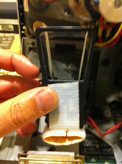

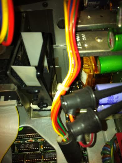

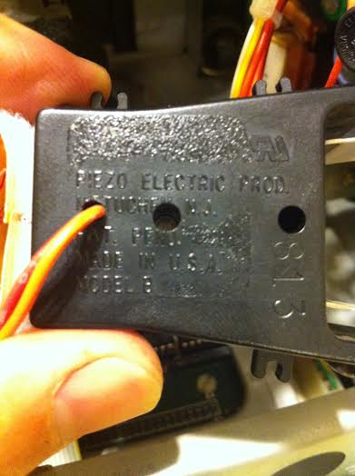

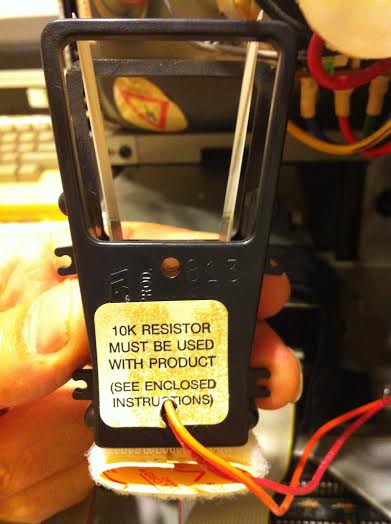

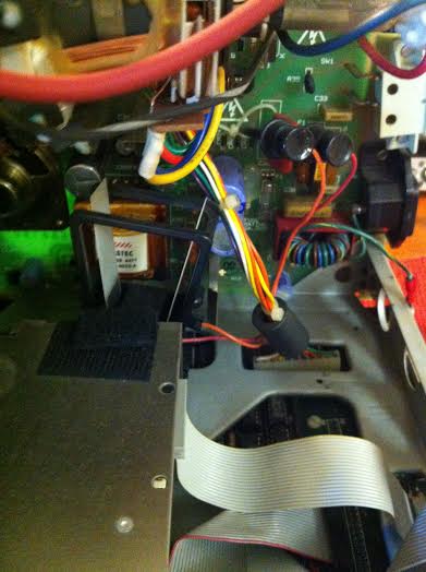

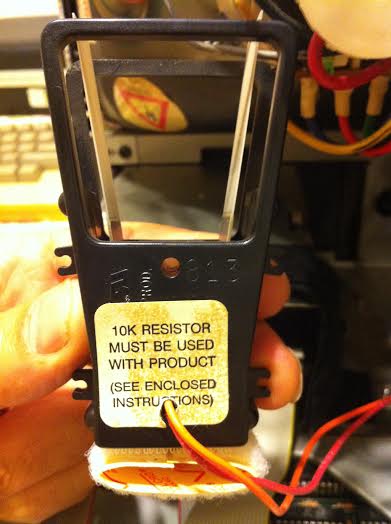

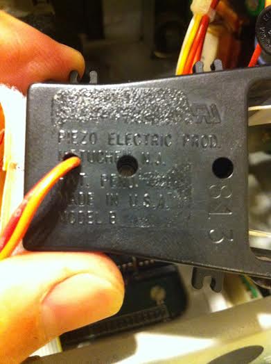

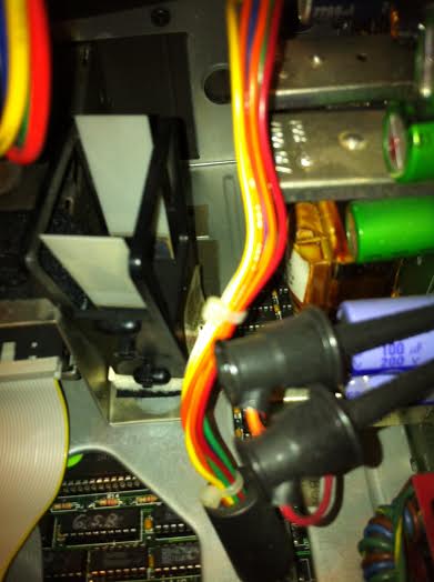

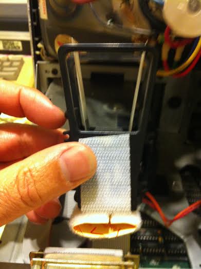

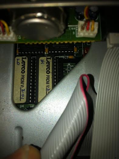

Looks like the unit itself is a so called monster mac made by levco, which had a 2 meg board.
The Weird piece seems to be a 'Piezo cooling fan' , I've never seen anything like it before 😀
Thanks for that. I've never heard of these. It seems the two white blades will vibrate/flap at the mains cycle frequency (60hz for you).
I do wonder how much use it really is. 😕

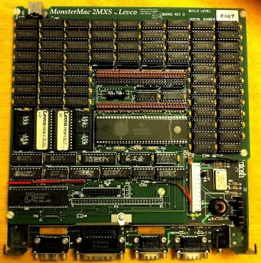

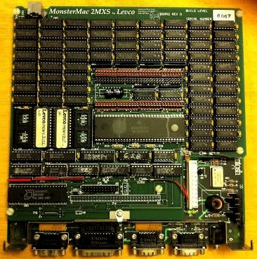

I am trying to find more info on the 'monster mac' seems like there is a connector for a hard disk?
How much are they worth?
I attached a photo of the motherboard
From what I know, there was a second card that plugged onto the 2MB upgrade board to provide a SCSI port. It seems you may already have that as seen by the gray flat ribbon cable with the red stripe. IIRC this gives you SCSI for an EXTERNAL drive.
As for value, it's an after-market, third party upgrade. Just how much they're worth I really couldn't say.
It seems the board is a permanent fixture too. IE, you can remove it, but the motherboard will be non-functional.
EDIT: This looks like a later board, but the SCSI port is certainly already present.
Looks like this thing was state of the art in 1984 🙂

I now suspect that the buzzing MAY have been a cable sitting against one of the vibrating piezo fan blades.
Interesting little device. Thanks for posting the video.
OMG I found out what the noise was. In the photo's you can see a label, It was lose and fell off. When it was gone the buzzing stopped , so I think it was the label vibrating
That would be it. The sticker buzzing. The point with those piezo fans was quiet, and it just kept enough air moving around to do the job.
